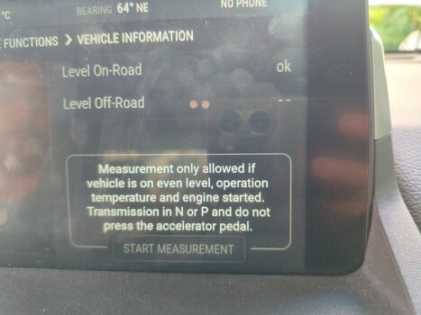

Anyone have an idea what I'm doing wrong here? Did an oil change, but I cannot check oil level? The "start measurement" is shadowed. Truck is on and in park on level ground.
