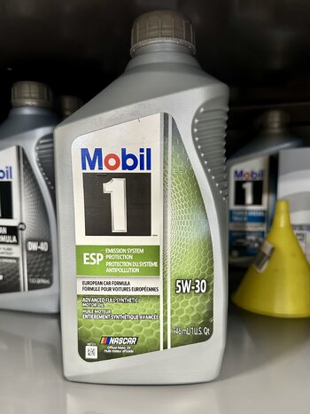

BMW LL04 and GPF Safe.
For what it's worth, newer B58s run even thinner oil than 0W-20...
If you're using 5W-30, make sure it is LL04 approved (pretty sure all the "FE" approved oils from the newer specs are 0W-20)
