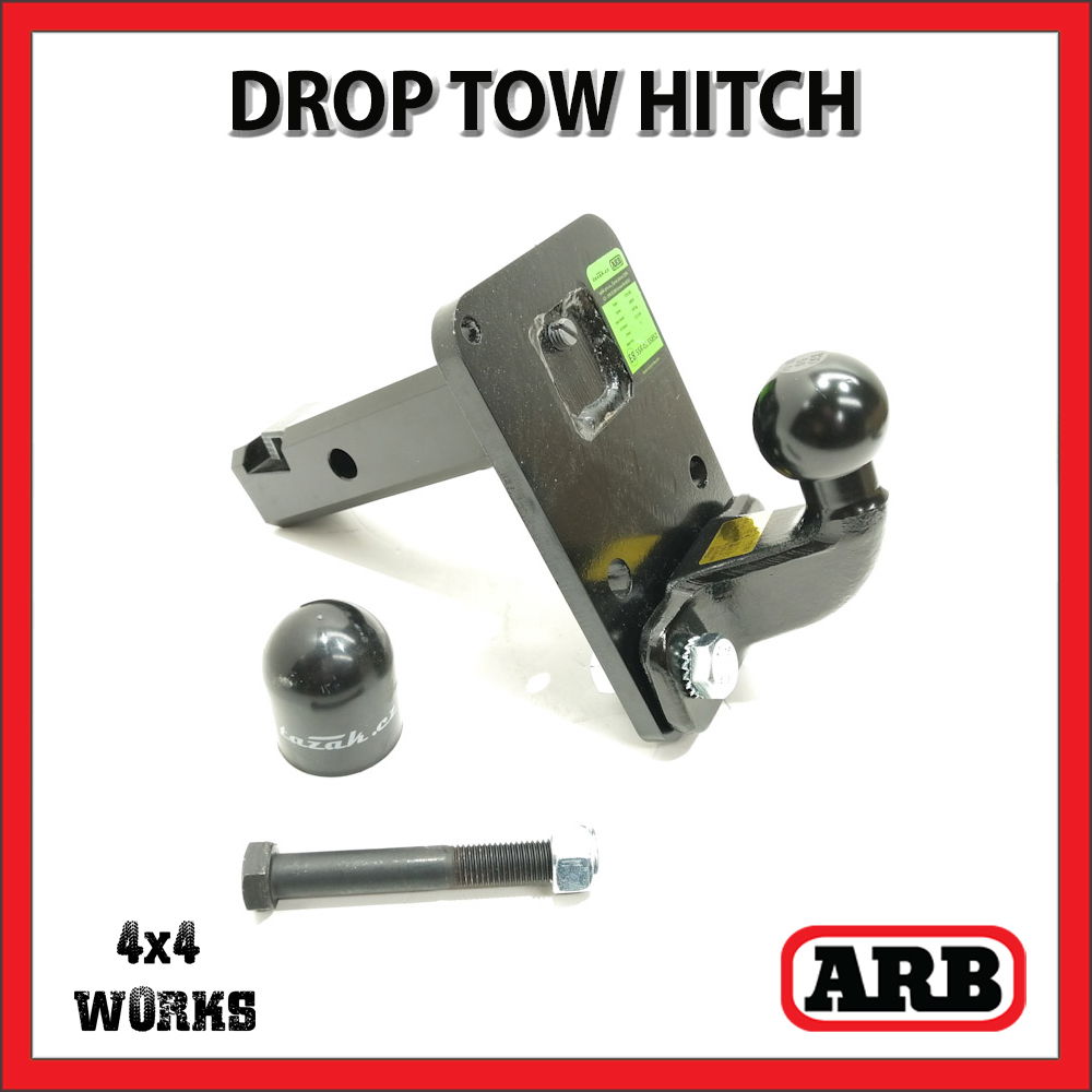

Are you ruling out something like this:

That looks interesting but I'd be included to stay safe and use a 2" receiver drop, at least that can be removed easily when not towing. I'd also be interested in how much the grenadier drops when the boot is loaded, rear passengers in and a caravan hooked on.

Not sure from that if you will use a 2" receiver or not?
If you would then I'd measure this up and see if suits.
Simple to remove/adjust. Torque the nuts up on the ball and ready to go.
Yep Would defo use the 2" receiver mate, will call them tomorrow.:)
