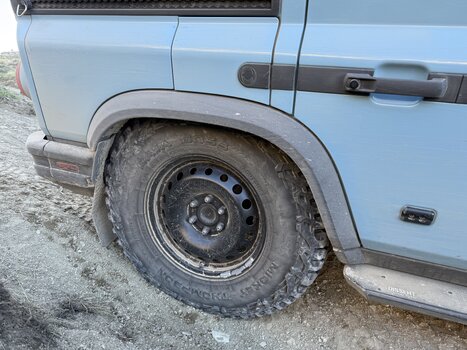

So I’m still on the original KO2’s with the 17” steelies. I did some green laning in July and did a one day Blue lane this past weekend in VT. I have 72k miles on the tires and while on the Class IV roads in VT last weekend the Grenny performed admirably. Had some slippage on ledge but it had been raining all day.
Looking at possibly swapping out the kO2’s to mickey Thompson Baja Boss 285/70/r17/ >90% of my future driving will still be tarmac but hoping to do some more off-roading.
I have no lift and have not adjusted the steering dampers…Anyone else have any suggestions?

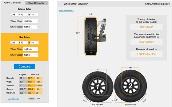

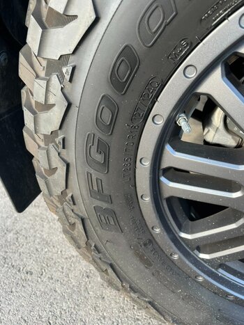

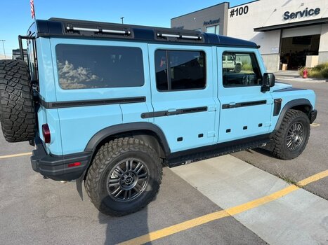

While at the Grenadier dealer to order some parts I ran across this setup while looking around at other vehicles to get some upgrade ideas. Black Rhino "Yellowstone" wheels in an 18" fitment with BFGoodrich Mud Terrains by the looks of it. Proportions look good and some extra sidewall height over my stock 18" wheels is nice bonus. Certainly giving me something to think about compared to 17" options I been considering and the BR's offset for this wheel is listed at +48 which is good as I'd like to stay as close to the stock wheels specification as possible.

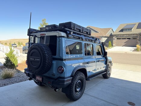

Just here to advocate for the Mickey Thompson 255/85r17s on stock suspension. In my experience, it drives better than stock with proper inflation, and does not rub even at full articulation. It’s like this tire was made for the Grenadier!
Circling back to the Mickey Thompson Baja Boss.
  • My stock Bridgestones 265/70R17 are 30.5" tall
  • Toyo MT 255/85R17 are 33.3" tall
  • Baja Boss 255/85R17 is 34.6" tall
I think I may have to go 255/85. It may make the speedo under-report, but should solve any off-road clearance issues.
