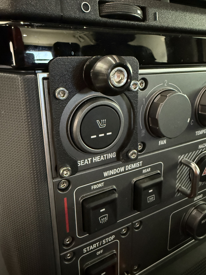

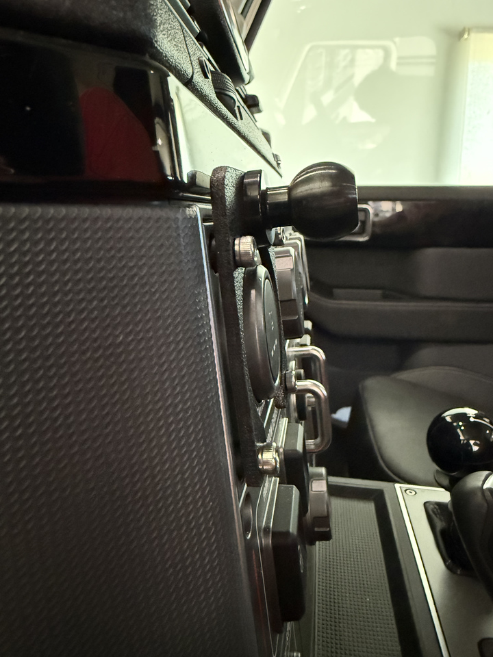

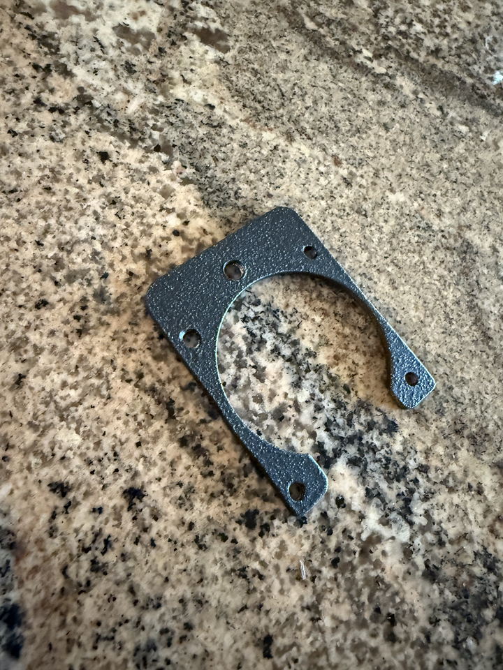

Here I made a second unit...first was only using two screw mounts. Here I am using 4 screws. I used 1/4 plastic tubing as a spacer to keep the place from scratching the factory plate. I bought a 35mm bolt for the long screw replacment, but I think it is still too short ( it wont tighten).
The mount and ball I am using is from Tackform (I had this on my Bronco). It's an anti-vibration unit.
I started with a scrap piece of aluminum I bought from my scrap recycling yard.
Cut it down and drilled holes, and tapped one hole. Painted with Bed Liner paint (great stuff!)
1/4 polyflow tubing spacers.
Small standoff to protect the OEM plate and graphics.
Here I preserved the "Seat Heating" description.

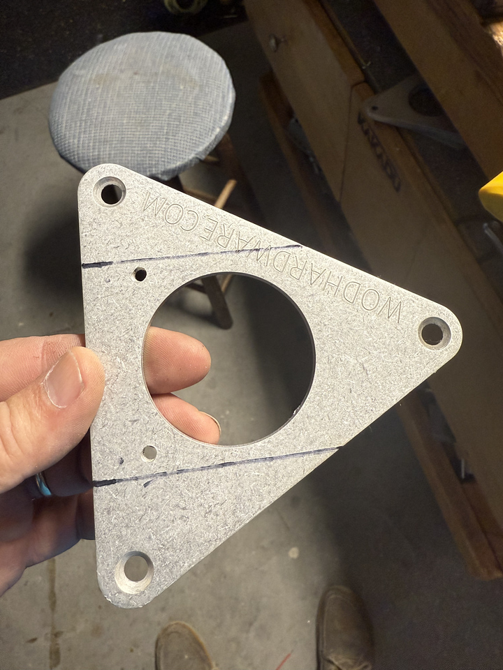

There's some creative solutions here in this thread! I considered several of them, but wanted my phone truly out of the way, so I made a ceiling mount for RAM ball mounts:
it fits in the overheard panel, that's "blank" from the factory, and the center plug is just to hide the hole through the panel for power cords. Personally, I love it, gets your phone out of the way, but still accessible when you need it. (and charges it at the same time) I'm trying to gauge if there's enough interest from the community to turn this into a product, if you'd be interested in one please let me know by dropping your email address here: https://www.octodyne.net/products/p/overhead-mount-for-ineos-grenadier
