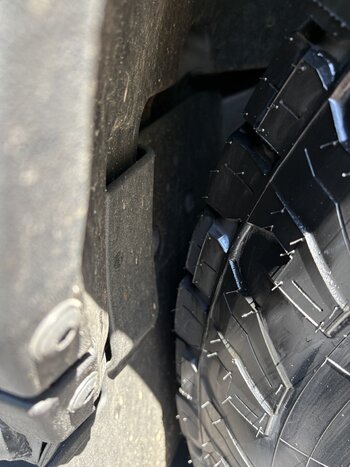

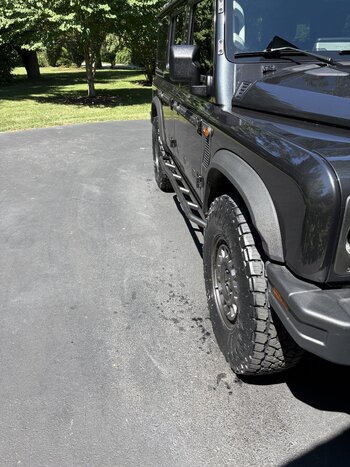

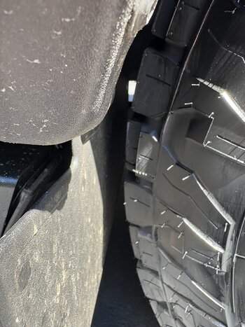

35 x 11.5 R17 fits with no issues. These are actually slightly smaller in diameter than the pizza cutter MT Baja Boss 255/85s that are popular, but about and inch wider. Wheels are 17x8 with 40mm offset. These Toyo AT3s are quieter and have a slightly better ride than my previous BFG KO3s. Both are load range C. These and the Mickey Thompsons are the largest you can run without a lift.

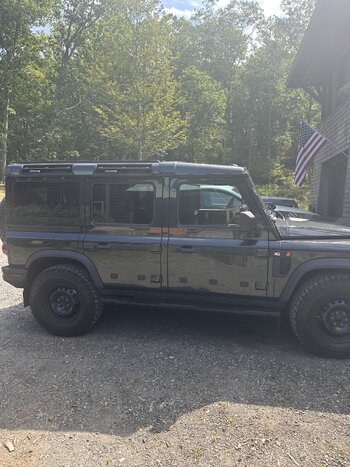

So I’m still on the original KO2’s with the 17” steelies. I did some green laning in July and did a one day Blue lane this past weekend in VT. I have 72k miles on the tires and while on the Class IV roads in VT last weekend the Grenny performed admirably. Had some slippage on ledge but it had been raining all day.
Looking at possibly swapping out the kO2’s to mickey Thompson Baja Boss 285/70/r17/ >90% of my future driving will still be tarmac but hoping to do some more off-roading.
I have no lift and have not adjusted the steering dampers…Anyone else have any suggestions?

This is exactly what I did and have been very happy. There are lots of comments in this thread.
