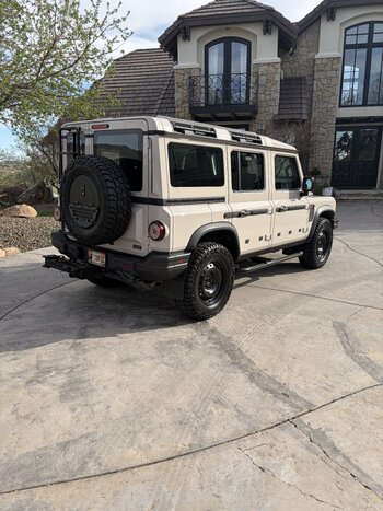

Largest Functional Tire Without Mods
Like this?
Looks great. No rubbing?
Not a slightest bit.
I'd have gone with 255/85, but given the only manufacturer at present, I decided to stay with a more-common size.
My speedometer is now bang-on accurate, and odometer (which was bang-on accurate with stock tires) is now undercounting miles by ~4%.
My gas mileage went predictably down from ~13.9 to ~13.5 mpg (wallet-measured over >20kmi each).
I did notice a small decrease in acceleration - not enough to be concerned, and I take curves with more appreciation than I did before.

| Stock 265/70R17 | ~10.4" |
| 285/70R17 (32.7") | ~10.8" |
| 255/80R17 or 285/75R17 (~33.8") | ~11.4" |
| 255/85R17 MT (34.6") | ~11.8" |
| 35" + 2" lift | ~12.5" |
## OPTIMAL CONFIGURATIONS — COMMUNITY CONSENSUS (2022–2026)
### **If you want zero headaches and good capability:**
285/70R17 BFG KO3 or Toyo RT Trail on stock steelies. No spare bracket needed. No rub anywhere. Quieter than expected. Easy.
### **If you want maximum height without mods:**
255/85R17 Mickey Thompson Baja Boss AT on stock 17" steelies OR Method 701/703 (+50mm). Requires spare washers or Leitner bracket (~$200). 34.6" actual diameter — taller than any 285 or 295 in 17". No body modifications. No lift needed.
### **If you want width + height balance:**
285/75R17 BFG KO3 or Nokian on stock steelies or alloys. Requires spare spacers. Multiple confirmations as of 2024–2025. Marginal at full flex with sway-bar disconnect.
### **If you want 35s:**
30–40mm Eibach lift + 35x10.5 or 255/85R17 (already 34.6"). For true 35" (≥35x12.5), need ~2" lift minimum. Warranty risk on driveshaft with any lift.
### **Pizza cutter philosophy:**
255/80R17 or 255/85R17 = narrower contact patch on road, **longer** contact patch when aired down offroad, better mud self-cleaning, lighter steering, quieter, better winter penetration, no steering wander. Preferred by many experienced owners.
## STILL UNRESOLVED
- Official INEOS maximum tire size statement
- Carraro axle aftermarket gear availability for regearing
- Long-arm lift kit feasibility
- Larger factory fender flares as option
- Full TPMS relearn procedure still not published by INEOS
- 285/75R17 at full sway-bar-off articulation — still only marginal data
## THREAD TIMELINE
| Pages | Posts | Period | Key Events |
| 1–5 | 1–100 | Jun 2022 – Mar 2023 | Early speculation, first fitment reports |
| 6–10 | 101–200 | Mar–Sep 2023 | 285/70R17 established as safe; 33" consensus |
| 11–15 | 201–300 | Sep 2023 – Mar 2024 | 255/85R17 MT introduced; spare bracket solutions |
| 16–20 | 301–400 | Mar–Oct 2024 | 285/70R17 and 255/85R17 become dominant recommendations |
| 21–25 | 401–500 | Oct 2024 – Jan 2025 | 285/75R17 gains multiple confirmations; body alignment issue discovered |
| 26–30 | 501–600 | Feb–Aug 2025 | MT 255/85R17 becomes clear consensus "best all-around" pick |
| 31–35 | 601–683 | Sep 2025 – Feb 2026 | Community fully settled; 33 vs 35 philosophical debate; Leitner vs washer resolved |
