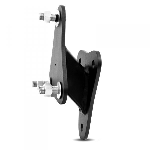

Finally, the question of fitting the spare without blocking the left door. On Jeeps, particularly with stock bumpers, the limiting factor is the crescent cutout in the top of the plastic bumper. Stock tires are 32s (255/75-17) and even a 34 won’t fit on the spare hanger because of that. But many aftermarket companies make a spare re-locator bracket, a simple steel bracket that attaches to the 3 factory spare studs and then angles up and out slightly, moving it’s own 3 studs to a point a couple inches higher than the factory. Like this:
With that I was able to fit 34, 35 and even 37s as shown:
These brackets are, like, $30 for Jeeps. Of course, one made for a Defender or Grenny will be 4 times the Jeep cost, but still won’t amount to much if that’s all that’s keeping you from hauling a 35” spare. An Ineos bracket would presumably lift and rotate the spare to the right.
