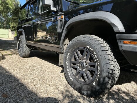

BF Goodrich k03 275/65/17 on OEM 17’’ wheels,
Eibach +1,2 front springs
Eibach same size back springs

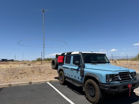

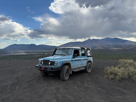

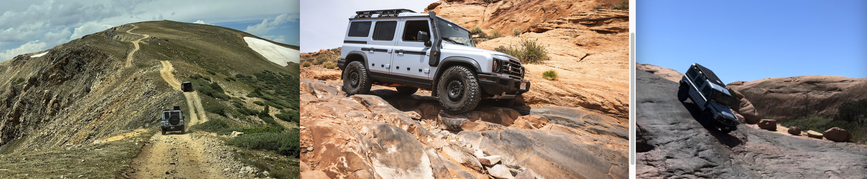

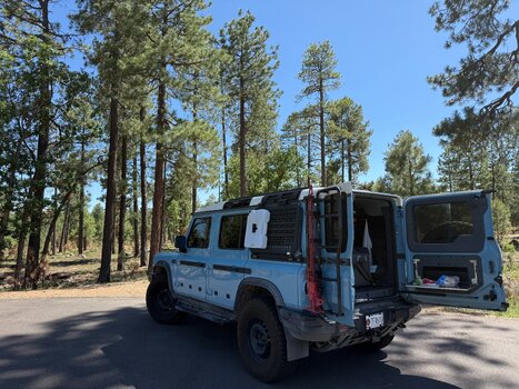

I have had Toyo AT 285/75r17's on the stock steel wheels for about 5000 miles. No lift of any kind, stock suspension other than the King shocks. A lot of hard offroad use, like teetering on two wheels full tuck while turning, rock crawling, high speed dunes, with no rub at all. Spare clears the rear door. Just got back from a 2,500 mile trip with no issues. If you don't want to go full 35" tires and lift, these are the perfect size.

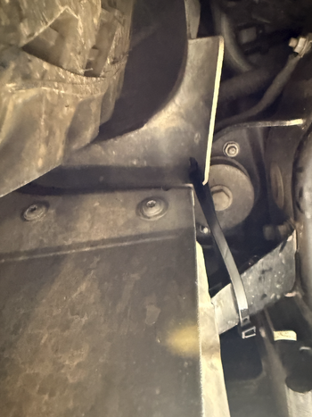

On my MT 255/85/17 after a month, I experienced some rubbing on the right rear when it was fully articulated up. It was the plastic inner wheel well, that I could push out of the way easily. So I drilled a hole and put a cable tie to pull it back about 1-½".

Hmmm Could you hear it rub or did you notice is on an inspection? I’m running the same tires and have hear them rub and I have certainly had it fully stuffed. That said, I have not looked to see if there are any rub marks.

I could hear something but never saw it until last time. It was only the rear right. It's isn't a big risk, the inner fender is flexible, there wasn't any damage. It just bugged me. And the driver side never rubbed.
