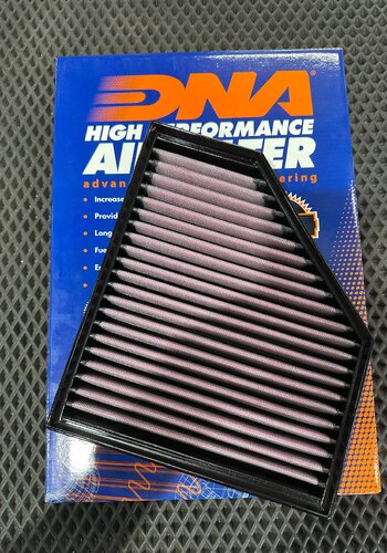

Hello Guys,
I tried this from DNA Filters to my B58 and it fits well.
135€ shipped.
SKU : P-BM30C21-01
Initially, I thought the same, but after doing some research, I realized it's a lifetime product.
It can be cleaned and reused, and it even comes with a lifetime warranty.
It’s more like an investment ; it starts paying off after the third service interval.
Just imagine using a disposable paper Mahle filter at every service. By the third replacement, you've already saved money.
I will share my feedback after some hard off road use.
