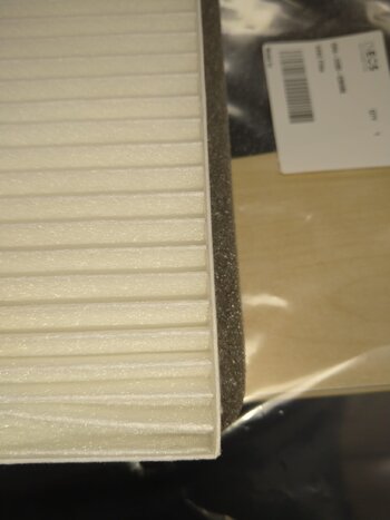

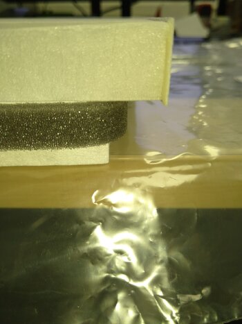

The 1 987 432 273 looks promissing. Just the foam of the original filter shows a little bit.

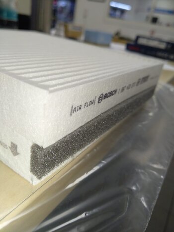

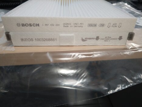

The 1 987 432299 is probably a bit too long. (see photos)
I will try next Week and report back.

The Version 1 987 432 299 doesn't go in far enough. So this one won't fit.

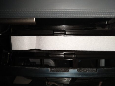

The 1 987 432 273 needs a little push to the sides to get in and fits not perfekt, but not bad at all. (see photo) At least it might be an option...
With active charcoal the number would be 1 987 435 595.
