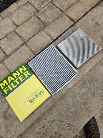

Well, just opened the Mann filter Amazon and several autoparts stores online suggested, and it's clearly a no-go. Not even close.
