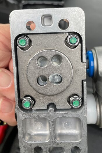

There are four holes in the plate on the underside of the shifter into which the spring loaded rod connected to the manually operated collar in the shifter. These four holes provide a positive detent for the high / low / diff lock shifter positions. I wonder if the vagaries in the cable setup would make milling a precise detent in between the H and L holes in the shifter a non starter - not to mention the lack of space between the & L holes.
Photos posted again to show underside of a shifter assembly removed from a vehicle.
