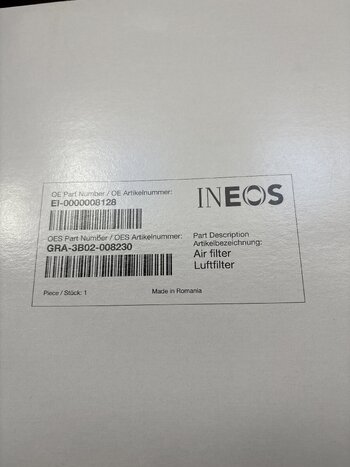

I copied and pasted that number from the Purnell Adventure Invoice. I will check against the Part number on the air filter box itself.
The box says GRA-3B02-008230. Table corrected.
The OEM Part number on the box was different also. I need to keep an eye on this and work out why there was a difference.

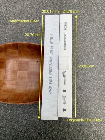

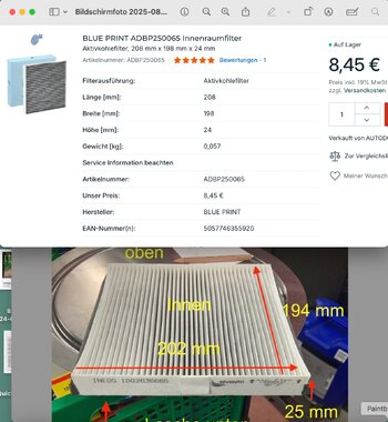

Try this one ADBP250076. should be direct fit This is MG cabin air filter

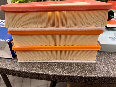

As suggested, I ordered the Blue Print ADBP 250076 filter for the MG. Unfortunately, the ADBP 250065 filter was delivered, but this wasn't a problem in the end, as it has the same dimensions and is also designed for an MG.
I compared the filter with the original filter used by INEOS. The slats themselves are the same height, but the plastic frame to which the slats are attached, is 5 mm higher than the one on the INEOS filter. For this reason, the Blue Print filter cannot be inserted into the holder under the dashboard of the INEOS. It doesn't fit!
What a shame, now we have to keep on looking for a suitable alternative to the original filter.Filter.jpeg

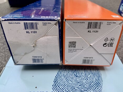

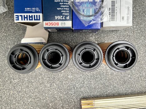

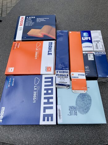

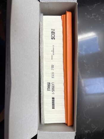

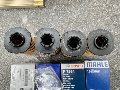

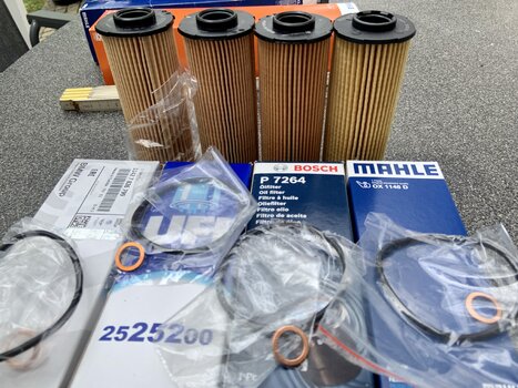

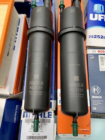

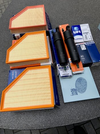

I bought these air, diesel, and oil filters for my Ineos Diesel. All filters, regardless of manufacturer and color of the box, are identical.
The BMW, UFI, and Bosch oil filters were made in Tunisia. The Mahle oil filter is from Bulgaria. The O-ring on the Mahle oil filter is attached slightly differently than on the other oil filters. However, I don't think this has any effect.
