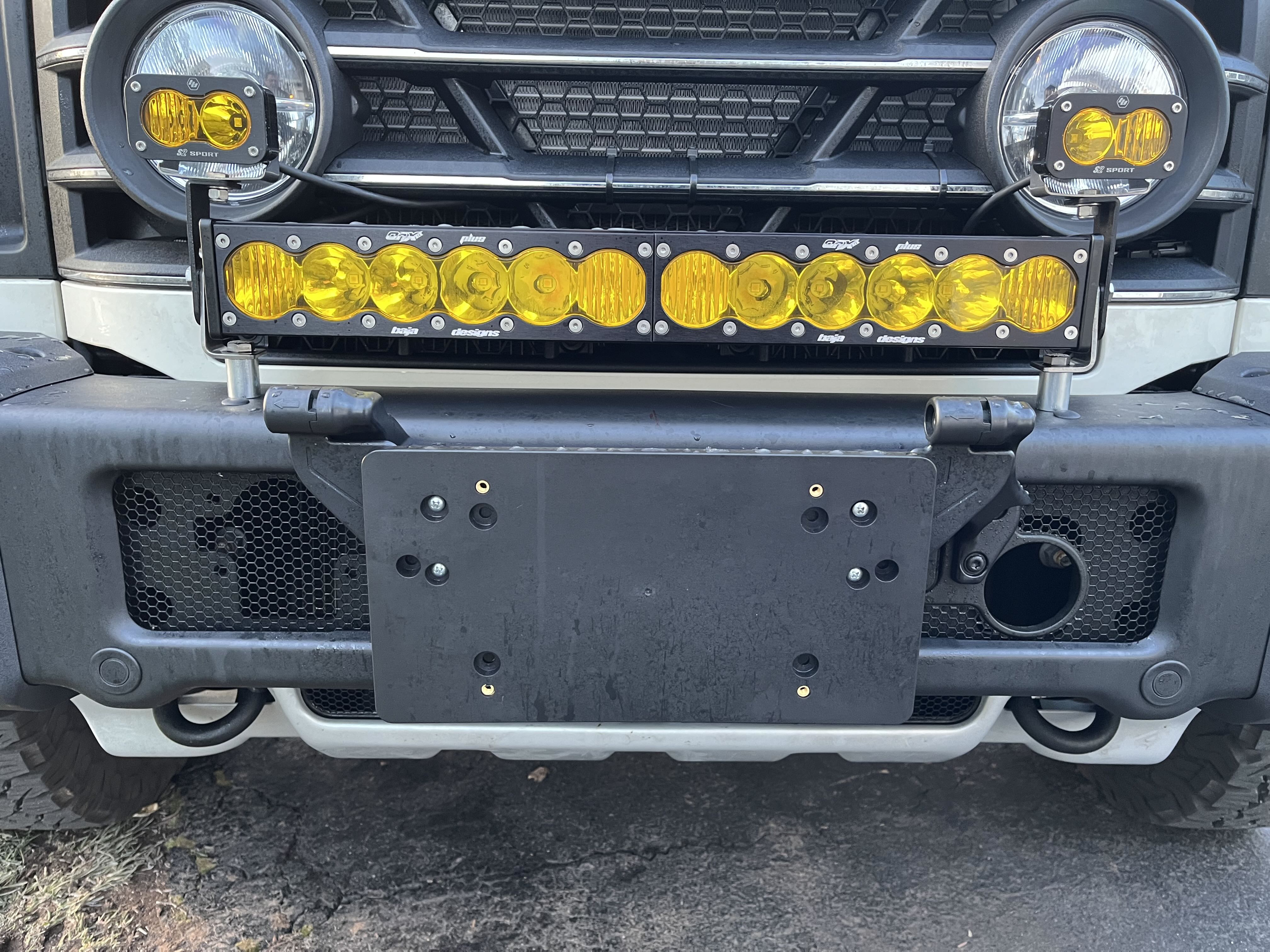

Ccam installed some BajaDesign LP6s on the front bumper, looks very nice - https://www.theineosforum.com/media/img_7594-jpeg.24386/
This past weekend I installed a BajaDesign On6x 20" light bar on my front bumper and I am very pleased with the result. I placed it on a 1 inch heavy zinc post so that it would not interfere with airflow in the lower grill. I have several BajaDesign lights on my Tacoma and they are all outstanding in design, quality and light output, I'm a fan. This is my first experience with the On6x model and holy cow, they emit a ton of light, more than I was expecting. With the On6x you have the option of tuning down the amount light that is emitted from the LED light by 30%. I did not opt of this, I went 100% The installation was relatively easy (of you don't count my small mishap, learn from my mishap). See below. I'm not sure I like the look of the BD S2 Sport lights that are mounted to the light bar, but I do like the look of the LED bar. I may change the position of the S2 Sport light, moving them closer to the middle of the grill so that it does not block the OEM offroad lights.
I may be wrong, but the grill is plastic, it did not impress me as a great spot to mount a light to. I personally would not mount a light to the plastic grill. I look forward to seeing your IG and your light set up and best of luck.
Hi LeonD, I like the elevated mounts on the bumper for airflow to both the lights and Grenadier vents too. Great to hear the light output is more than you expected. Your idea of mounting the BD S2 lights more to the middle would be functional because you could adjust them to shoot straight or arc them slightly to the side. If there is room, you could also accomplish the same thing by mounting them to the side of the linear light bar, which would also look nice and give you the same adjustability for light throw. DaBull
