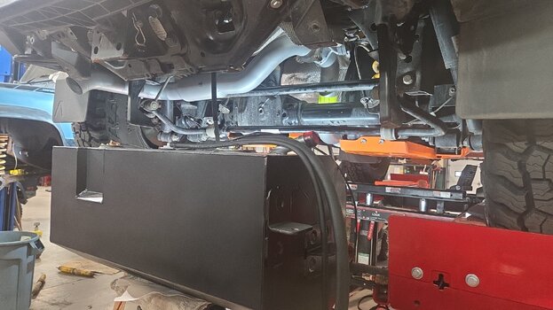

FINALLY the Long Range America fuel tank arrived! I had the folks over at Apex Overland install it yesterday, and for the first time ever, made the drive home without having to stop for fuel along the way :P
The simplified install is as follows: Drop the rear bash plate, cut the factory exhaust, remove the exhaust from the mid-resonator back and toss it in the metal pile, remove the OEM fuel filler neck, mount the transfer pump, and then just pop that auxiliary fuel tank into place and reinstall the bash plate. Oh, and run a harness into the vehicle to install the gauge/pump switch in the dash. Super simple, right?
The install took about 7 hours, including a brief wait for an upgraded Edelbrock fuel transfer pump. The pump included with the kit has been known to fail in a handful of vehicles, including on Apex's own 5th gen 4Runner, so we proactively replaced it with the slightly higher flowing Edelbrock unit.
As mentioned, you remove the OEM rear muffler and replace it with a small resonator and a single exit tip (on the LHD driver's side). There is definitely a bit more rumble from the exhaust, but certainly not loud. I would say the rumble is primarily on the outside of the truck. As the first vehicle I've had in >15 years with a modified exhaust, I can't believe I went through so many vehicles without it :ROFLMAO: There wasn't a single overpass on the 6ish hour drive home that didn't illicit a "window down, downshift"maneuver. The LRA tip sits substantially higher/more tucked in than the OEM tips also; something I appreciate as the last outing partially crushed the OEM passenger's side tip
Back to the fuel! While the muffler weighs a good bit (more than the tank), it still has 145lbs of fuel inside of it, which definitely adds weight to the rear end. My first fill up of the aux tank got 24.4 gallons before the pump clicked, so notably more than 1 full OEM tank is available for transfer. I ordered the Metalcloak 1" rear spring spacers, however, the spring compressors they had on hand were unable to sufficiently compress the uprated OEM rear springs enough to fit them; so they'll be in the classifieds section soon. Since I probably won't have fuel in the aux tank all the time, I may just handle this with airbags, or do nothing at all.
While transferring fuel from the auxiliary tank to the main tank, the rate is something along the order of 40 miles of indicated range per 4-5 minutes of transfer (while driving at highway speeds); so ~0.8-1 US gallons per minute by some horribly inaccurate math. The OEM fuel gauge/range is not quick to update as fuel is being transferred. After those 4-5 minutes of fuel transfer the new amount probably didn't register fully for another 3-4 minutes. I'm sure this would be quicker when stopped, just like while fueling up from a gas station, but at 70+MPH the algorithm slows down refresh rate due to sloshing/movement substantially. The LRA gauge/pump switch comes with the appropriate length wires/etc to tap off of the fusebox in the dash kick panel, and, despite the instructions saying to install it almost in the middle of this knee panel, I had them align it to the left side which is a bit easier to see and interact with. The fuel level LEDs are on anytime the ignition is on, and depressing the button turns on an orange light to let you know the transfer pump is on.
Filling the tanks is very similar to original, except when you take off the (new) fuel cap, you have the ability to select which tank you want to fill. The rearward hole is for the aux tank, the forward hole is for the OEM tank. I do wish the new fuel cap had a retention lanyard and/or fit into the OEM holder spot, but alas, it does rest inside the lip of the opening while fueling.
All in all, super happy with the upgrade as I've always felt the fuel quantity was a bit meh on the Grenadier... not specifically for off road trips, as for most off pavement routes in the US fuel is not an issue, but more so for road trips. I've been spoiled by having larger aftermarket tanks on the last few vehicles we've had, and now the Grenadier carries almost as much as the rest.

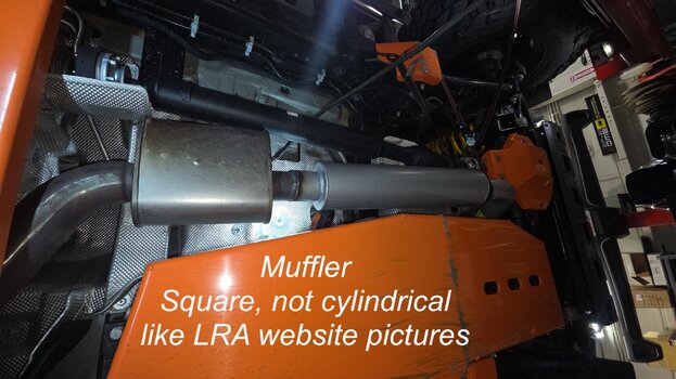

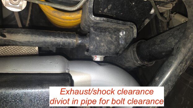

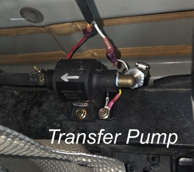

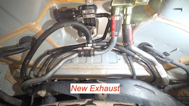

Long Range America auxiliary fuel tank - some info.
I am very happy with the product and install. I had worries about the exhaust noise, I believe it is a little difference, mainly in tone, not in dB. I assembled a amateur
video, hopefully it is a help. But it is too large to upload on the Forum, so go find it on FaceBook.
I have not taken it on any trips yet, the first is coming up. Thanks to Jeffrey Corwin at JC's British 4x4 for the great install.
I followed the advice of the community and had Jeff paint it with undercoat, I like the black rather than the silver.
One note, if you want to upgrade your suspension, you need relocatable reservoirs, as the tank is in the way.
