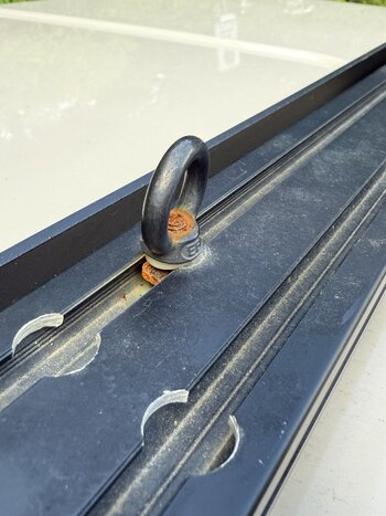

What are people’s expectations around exterior bolts in the BG Roof Rack?
Leaving the Grenny out for the winter (Central Europe) these bolts in particular seem to have suffered quite a lot of rust.

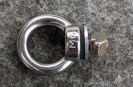

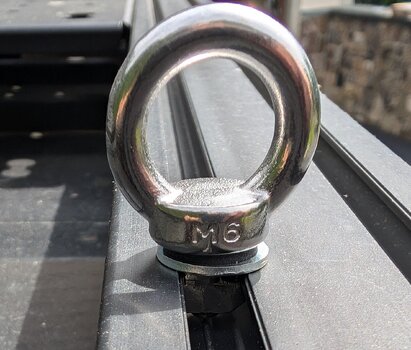

Looks to me that the ring is fine and the bolt itself is not fit for outside use. A lot of these are Chinese junk. Your best bet is to find something marketed as 316 stainless. I found some on Amazon that have worked for me. Unless I'm actually using them, I take mine off too.
It also looks like you should be using a washer with your eye bolt. I don't see a lot of metal on top interfacing with the rail.

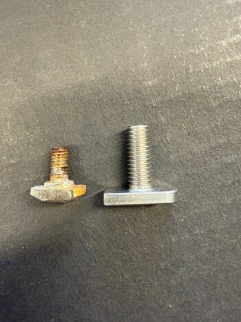

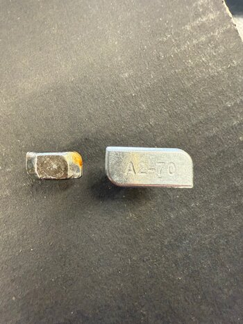

Hi, I have the Bison Gear 3/4 rack and am trying to fit the camp table. It was shipped with instructions for the internal Molle panel for a Ford Bronco and these T bolts. Shown here next to the t bolts from the accessory trays that go into the rack. Are these are the wrong ones, or am I being extremely stupid, I’m just going to use the spares of the ones I have because I can get them into the tracks. They also corrode easily, so will be swapping them all out for stainless.

Hi, yep, same one I found. However the Grenadier table is mounted at the rear as per the photos on the website, not into the side, which these instructions are for. My rack doesn’t have the panel on the side they talk about using and the fittings to re-use. And the T slots provided are huge, unless you’re supposed to remove the sides of the rack and slide them in but I doubt they’ll fit. I’ve mounted it now using the smaller T bolt from the accessory tray.
