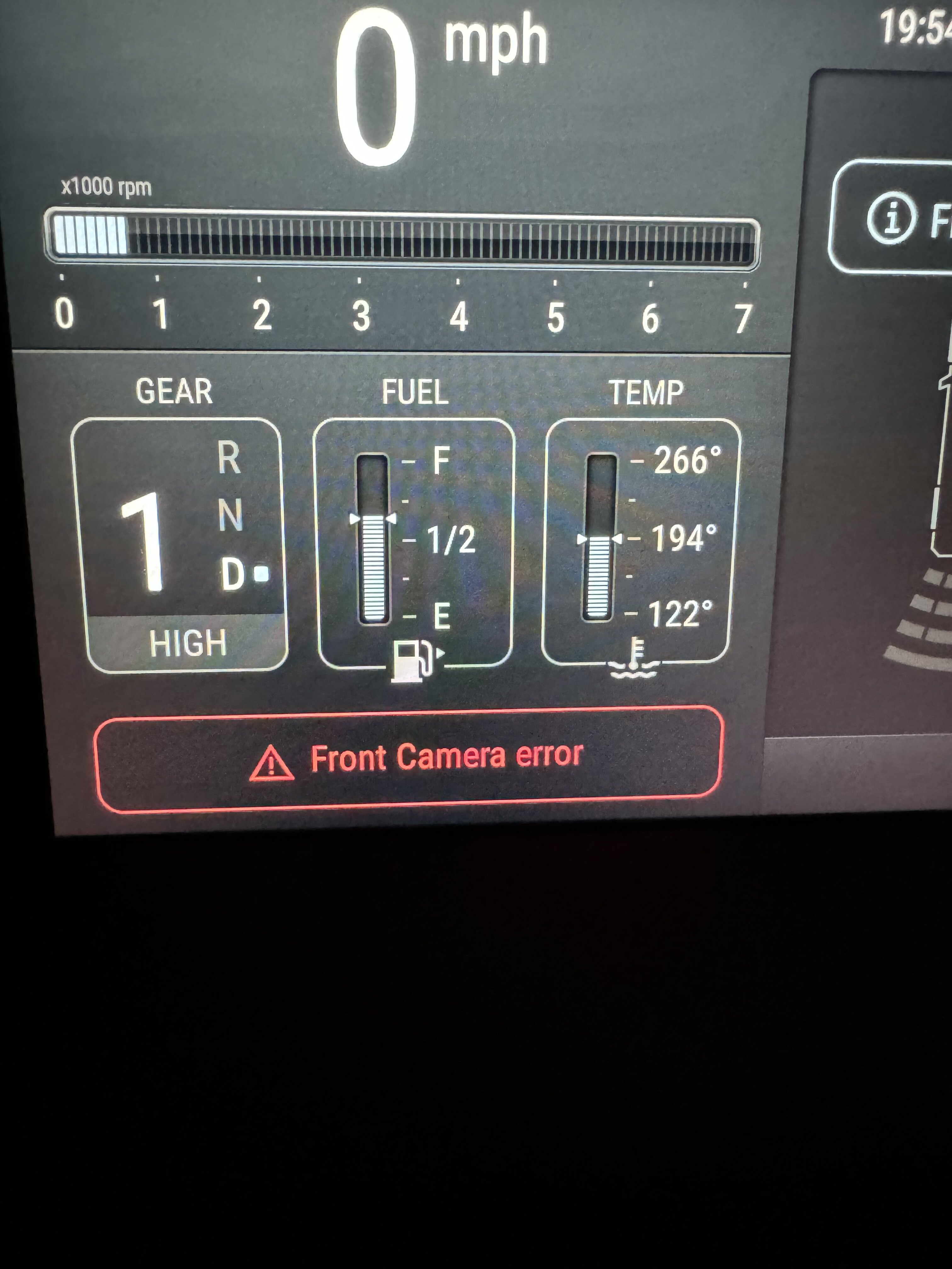

Ok, View attachment 7836325View attachment 7836326I just pulled it. The good news is the annoying sound stops.
The bad news is the dash lights up like a Christmas Tree. Looks like it also disables the auto break. Also, the Centre screen displays an annoying warning.
I'm going to put it back, but Ineos please fix this! I shouldn’t have to decide between basic safety features or a sound like I’ve left my indicator on.

All - Sorry for not posting this sooner. I covered the camera and pulled the fuse a week or so ago. As reported above, it kicks off a lot of error messages / warnings in the Telltale Display as well as on the lower left of the main display. Its very similar to putting the vehicle in Wade mode. If you havent done that yet, you are in for a real light show!
What happens if you just cover the camera?

My dealer (RDS) explained they have a 2-step solution to turn off the ADAS ISA, that only involves hitting the favorites knob/button (?), then one tap on the screen. They will set this up for every customer. He also said they have pushed this back to Ineos, saying EU regulations are “Not acceptable in the USA”. I think we all need to provide this feedback direct to Ineos.
