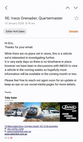

A little progress, but still no commitment, but thanks for the effort and update.I emailed Safari Engineering, the screen shot attached is there reply.
