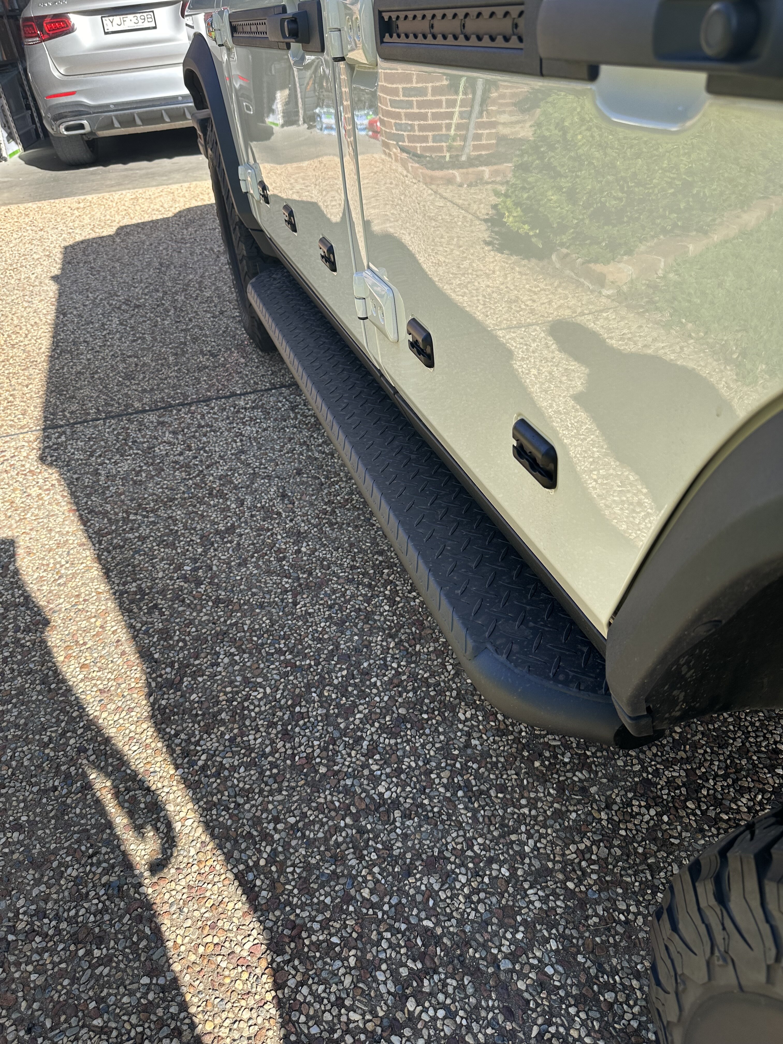

Factory side steps are mounted on three points and although very strong are a bit low for me and I will change at some point to combined rock slider steps. IMG_1781.jpeg
