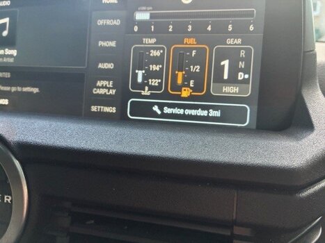

My two thousand and however many days overdue service warning has been replaced with Service overdue 3miles. Figure is increasing in line with the odometer. Perhaps I have had an unsolicited over the air update?
Let me assume the following about your situation -
* You were NOT overdue for scheduled service on 1st January, got the New Year overdue bug like the rest of us, and are still within a pre-service interval (not overdue by any valid measure)
* You made no attempt to visit the menus related to this
* You did not visit your Ineos dealer this week
If most of that is correct, then your new overdue message is still wrong. Let alone, what happened to change it?

Correct on all fronts. I am booked in to see the dealer next Tuesday for a service (arranged before Christmas). I look forward to hearing his explanation. It will probably be as helpful as my IT Departments explanations as to why something won't work on my computer.
