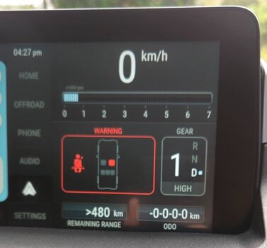

It doesn’t solve everything like trailer light warnings but it does substantially reduce glitches like blank screens, dropped phone connections, telemetry displaying on wrong side, false odometer reading 0-0-0-0, etc.
I had this about a week before the overdue bug reared its ugly head. The ODO showed "-0-0-0-0 km". Any ideas?
