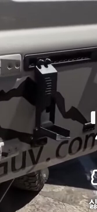

안녕하세요, 사진과 비슷한 유틸리티 레일에 도어 사이드 스텝을 설치해 볼 계획입니다.
사용하기 가장 좋은 유형의 L-트랙 볼트, 재료 또는 설치 방법에 대해 조언해 주시겠습니까?

"Hello, I'm planning to install a door side step on a utility rail similar to the one in the photo.
Can you advise me on the best type of L-track bolt, material, or installation method to use?"

One consideration, the utility rail is only rated to hold ~40kg on the door
Buzz and DVA both make one, I opted for the Buzz kit like the photo. Very happy with it. Note the factory bolts can be difficult to remove would advise having your dealer break them loose before attempting install.

I’ll have to ask the dealer to release it.
As you say they were bloody tight so have to make sure you have really good torx bits or they’ll snap.
From what I remember you put new screws on that come with the steps.

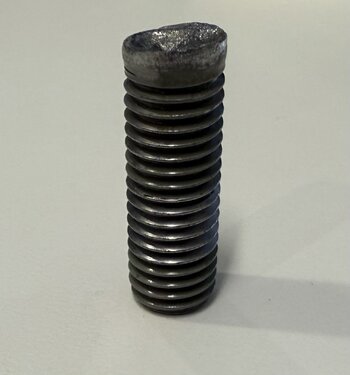

One of mine was over-torqued from factory and had a lot of paint in the head, I stripped it and it took 3 master machinists at one of my factories half a day to get it out. I'd suggest either:
(1) get a 1/2 inch drive (or metric equivalent) T50 socket, use with a breaker bar (long socket wrench) and GO SLOW
(2) ask your dealer to break them all loose for you, after that it's very easy
I would suggest #2 option after that you're looking at a 10 minute install if that.
This is the bolt shank after they finally got it out, had to drill the head off first. You do use new screws that come with the steps, your original ones will 100% have at least some marks on the paint when you are done. You can touch this up easily and worst-case scenario a new factory door bolt is under $10 USD.

One thing we have found useful to release the factory bolts is to put some
Plastic sheet over the bolt before inserting the torx bit. Something like a plastic shopping bag. This takes up any play and helps prevent the splines from stripping.
We also find using a cordless impact set to the “undo” option handy (I know the Milwaukee impacts have this) as it pulses the impact as opposed to putting max torque through the bolt which can help break them free.
