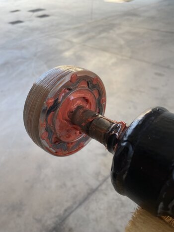

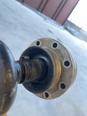

Today, less than 1,000 km after installing the 1.2-inch 😶 Eibach front springs to level the front and rear, I discovered a broken front transfer-side shaft bellows. I already had a new Teraflex 1745000 joint at home, but the installation is proving much more complicated than expected: the transfer-side shaft refused to come off, and neither did the joint itself.
I'll try to finish installing the new joint tomorrow, but are there any aftermarket universal joint or double universal joint shafts that I've tested that don't vibrate like CVs? If I remember correctly, they were all vibrating.
Did they disconnect the drive shaft when installing the springs? Having damage after only 1,000 km with just a 1.2-inch lift seems a bit too soon. The damage may have occurred during the spring installation.

Yes, i’ve disconnect the axel side at first.
Did you support the prop shaft during disconnect, as if not supported and left to hang it is thought this may be contributing to the cv boot failure

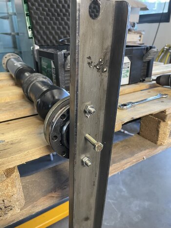

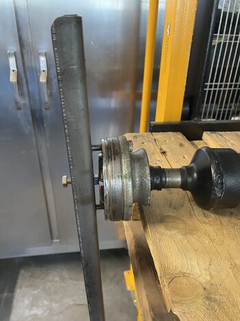

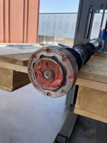

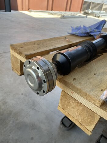

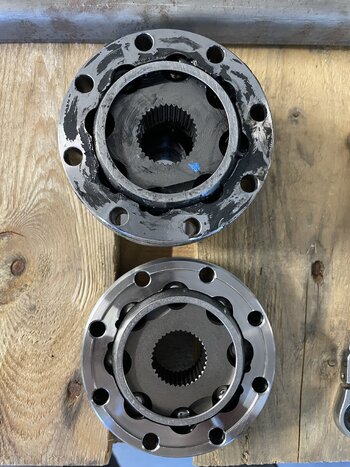

Job done. The two critical steps were: removing the CV joint from the gearbox flange and removing the CV joint from the shaft. This last step, in particular, wasted my time because I had to create a puller. The joint, in fact, seemed to have been inserted by interference, unlike the new one, which had no difficulty whatsoever.

On the new joint did the splines engaged tightly with no free play? It could just be the photo angles, or my old eyeballs, but the OEM joint splines appear to be more defined and a little deeper compared to the new joint. Also, is that a master (wider) key spline on the new joint? It would be frustrating to go through all this effort for a little slop in the splines to create a drive shaft knocking noise during on/off throttle. Certainly glad there is an option for a repair rather than replacing the whole shaft at least… good job on the repair!
Did you have to cut the cap open with an angle grinder to get to the circlip ?
On the new joint, the splines fit together with no free play, but not tightly. The two joints certainly have different tolerances. I hope this doesn't cause any unusual noises. In the shaft there is no key spline.
