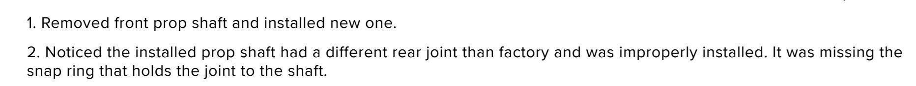

Got the result from my failed CV from Ineos today. Looks like the previous owner did not have the Teraflex CV replacement installed correctly.
Missing the circlip? That sounds like it was lucky to make 10 miles let alone whatever you put on it! Unless they mean a different one?

I was able to get a quick peek at the transfer case CV that was taken off by the dealership. The comments from the mechanic states that the circlip was missing on the transfer case CV. I haven't taken the whole thing apart but it appears that the rubber boot is intact I do not see any tears. I'll take pictures this weekend. Been working s lot....

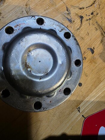

I checked the rubber boot and it's not torn. There's no holes in the back side like Matt who's driving around the world had. It appears what happened is that the circlip got dislodged and punched a hole in the housing which then released grease - see picture below. I'm guessing a bad install job by the previous owner or shop.

I checked the rubber boot and it's not torn. There's no holes in the back side like Matt who's driving around the world had. It appears what happened is that the circlip got dislodged and punched a hole in the housing which then released grease - see picture below. I'm guessing a bad install job by the previous owner or shop.View attachment 7924240
Mine popped out the back. I actually had a failed boot and a clip coming out the back. That one coming out the front is crazy!!!
