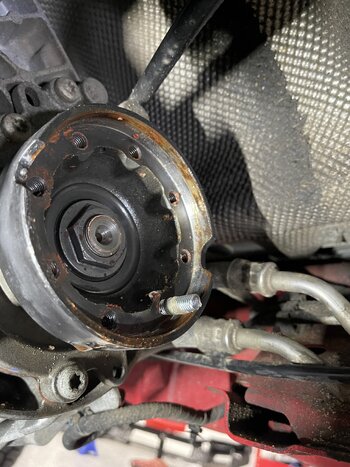

I sheared off two bolts on the diff end when my shaft unlived itself. Double nutted and grips got them out.
Do you happen to know the dimensions of this nut? The diameter at the bottom of the washer and the wrench size?
Was it perhaps an M26 x 1.5?

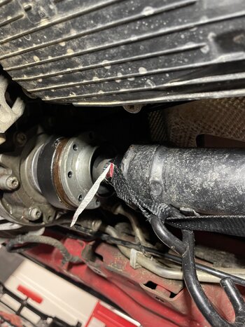

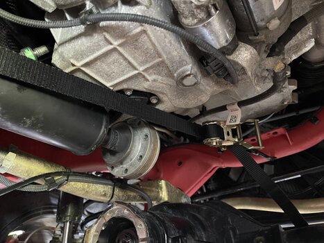

I put in the FB comment about using the ratchet strap, and yes, sometimes it takes a couple whacks with a small deadblow hammer once you have tension on the strap. As Dokatd commented, the strap goes around the transition on the driveshaft, not the CV. I broke one bolt on the pinion end, on my second replacement (#6 currently installed). The bolt that broke was an Ineos replacement, which has a red/purple colored threadlocker. I now remove the factory threadlocker from new bolts with a wire wheel and use blue threadlocker instead. Waiting on word on another prototype shaft that is under development before I pull the lift or drop down to the 1.7.
Ratchet strap and hitting with a punch/hammer got it loose. Thank you. But I had to drop the crossmember to get the leverage I needed.
And I’m still working on the pesky broken bolt.

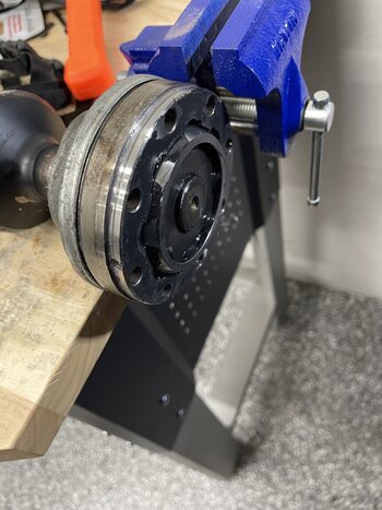

Hey @Dokatd I’ve made big progress but holy heck now getting the CV off is proving to be a task too. C clip is out and I can’t get it to budge. Beating the hell out of it! Any pointers?

Some have to be pressed off, some fall off. If you know someone with a press that's the easiest option to be sure. Otherwise any independent auto shop should be able to press it or a machine shop. I can probably get you into a shop in Boulder if that's not to far.
