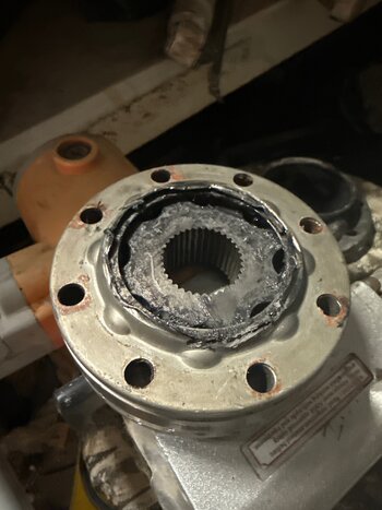

Scott Brady from Expedition Overland mentions IA "fixed" the front drive shaft issue. Given that this content was uploaded 5 months ago, was there in fact a documented front drive shaft update released by IA?
View: https://youtu.be/vLOskm23730?si=Kdv1twmTuCZr7qF1&t=1540
My new front driveshaft has exact same CV’s as the one that failed. The dealer said they are the same. Barring some news that the boot material has changed and we just can’t see that update, I don’t believe that it is fixed.
Of those who have fitted the Teraflex hi-angle, did you happen to notice if the throat of the coupling is wider than the standard Dana-Spicer coupling? I'm curious if a part of the problem is pinching of the boot against the coupling mouth at the 4 to 8 o'clock positions. Obviously the hi-angle CV needs to allow for more ball travel also.
My dealer advised "you wont have another issue" and "im not supposed to mention this" but the cv rubber is thicker
he may have been just placating me but...
The Terra joint and the stock IG joint are virtually identical. There are minor changes in the stampings. But the throat for the shaft is the same more or less.
