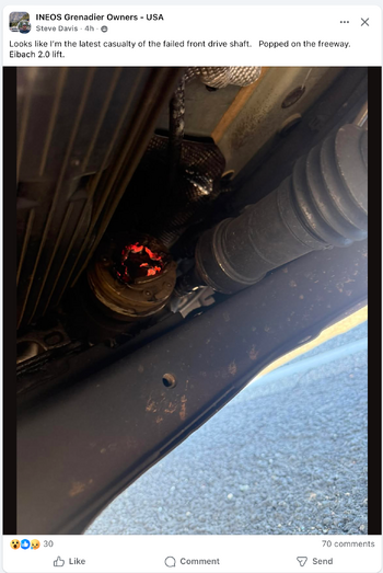

Note mine but posted 4 hours ago on Facebook group by Steve Davis. 2" lift. Melt down for sure.
I will not be lifting my truck.

Lifting your truck has to be considered a game of Russian Roulette at this point. No lift is going on my rig. Perfectly happy with the stance on the OEM suspension and 255/85R17 Mickey Thompson tires. I might replace the shocks but they will match the length of the factory units from Sachs.
