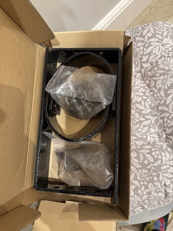

have purchased some insurance for when eventually get a new front prop.
tks to @landmannnn
Send me the link please . Isn’t it crazy though that we feel the need to buying such things on a new vehicle !
Yes it is. It was the secondary damage to the transmission and TC plumbing that prompted me to start talking about it, like your experience. @landmannnn has found an off-the-shelf solution (y)

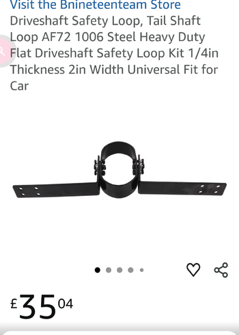

Is there a link somewhere where I can pick those up in the UK
Amazon - type in
Driveshaft safety loop
They look like this

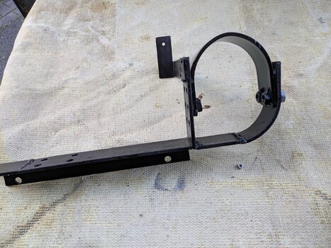

Basically the process is to take the right arm out of the equation and weld some angle on the left side to pick up the 2x M10 bolt holes in the gearbox cross member.
You could do it with nuts and bolts so a welder is optional.
This is what I did. With retrospect I should have just used the bottom loop rather than what I did here.
The other bracket retains the Bowden cable for the T box as I saw it rubbing, optional extra!
Perfect thank you. I will just bolt on some angle iron to the loop to achieve the same affect instead of welding.
