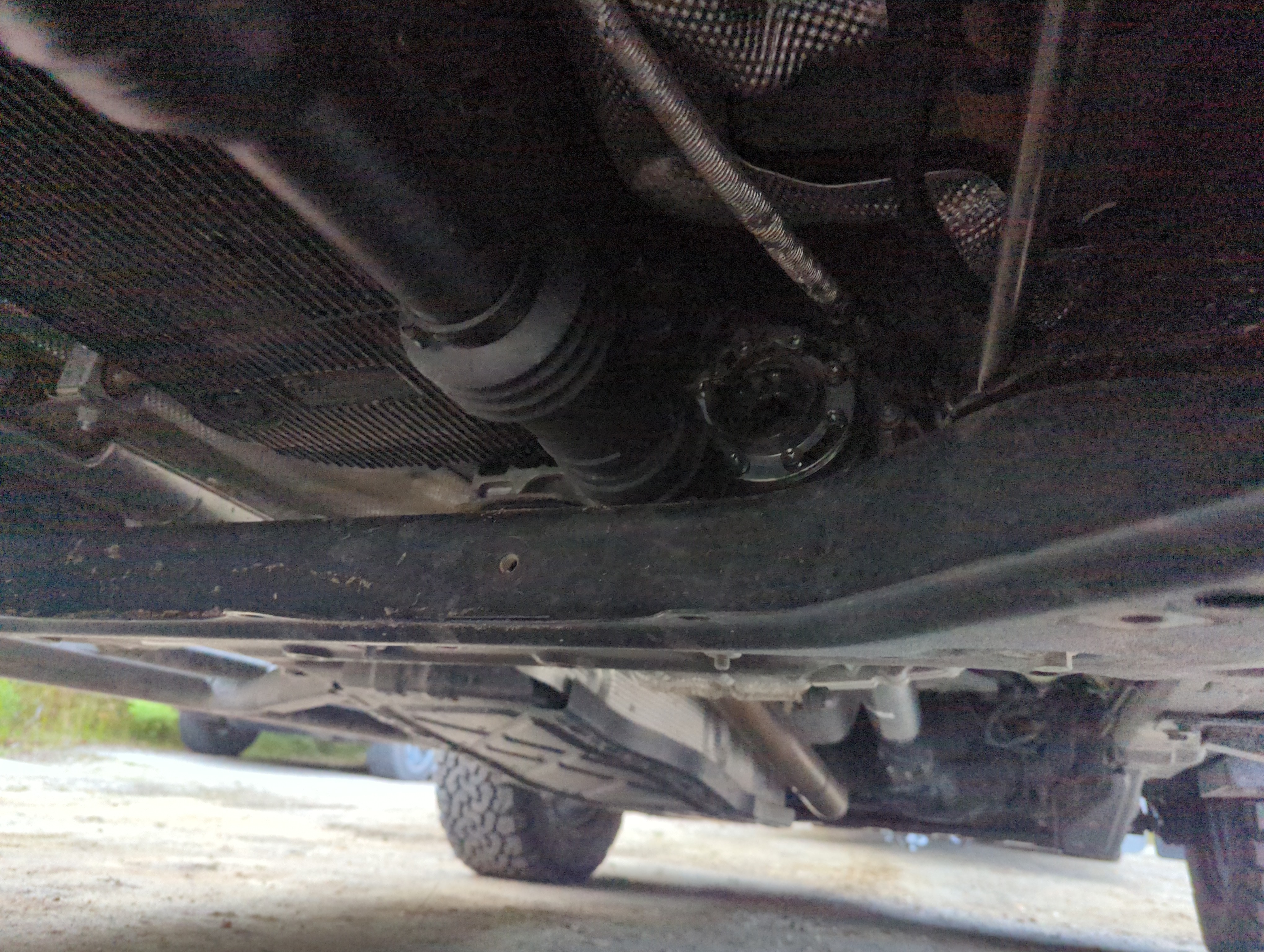

Hi all, so my front drive shaft came off today done nearly 14000 km.
Wasn't doing anything outrageous, just happened to be taking off (slowly while towing) when there was a loud bang and then I couldn't drive forward or reverse without locking the centre diff. The front drive shaft has come away at the rear end of the shaft.
Will let you know what happens with the repairs.
Edit 1. For those who are mechanically-minded (not me) the circlip is still intact, there is some damage to the shroud where the drive shaft meets the transfer case, from what I can see. I will know more in a few days once it gets looked at.
Edit 2. Initial diagnosis looks like the transfer case has seized which caused the drive shaft to brake, this all still needs to be confirmed though! So far the process has been great, the dealer has been in contact with Ineos and now we will see how it goes.
It seams that there has been a recall for transfer cases on some vehicles, I believe that mine was outside this range (built too early) but this has not been confirmed, and I haven't received any recall notice.
Edit 3. After a full inspection the transfer case is fine (not sized), it looks like the circlip failed which caused the jack shaft to come out. A new shaft is being flown to TAS (the only one in the country) I should be back on the road tomorrow or the next day.
I've had very good dealings with Buckley's motors in Launceston, and appreciate them fitting me in. Well done guys!
Edit 4. So the drive shaft has arrived but there is damage to a coolant line that needs to be replaced, this has pushed out the vehicle to be ready next week.
Edit 5. For reference it's been 2 weeks and 2 days since the incident and I just got my Grenadier back. The coolant line took some time as there wasn't a replacement so it needed to be made (as is my understanding) and they needed to fit me in.
While it was a bit longer than expected I'm glad I have it back and grateful it could be seen at short notice. Thanks

Question is, was it the drive shaft or a faulty assembly?
We have seen more than one loose bolt ... 🤷‍♂️

That’s rough. If you get a good close up of the failure by the CV joint you sometimes can tell the failure mechanism.
Hope that you get back safely and IA come through with assistance and a super quick repair.

Isn't it possible what we do with a Landy if something in the rear or front drivetrain breakes?
Remove the shaft, lock the center and drive on.
I would have thought so. Assuming the correct torx bits are in the kit.
AWo
There's no reason this shouldn't work the same way in a Grenadier... Important part of that process "remove the shaft"

Pull the shaft. Drive it home…

So given the autopsy findings in the original post , the question is why did the circlip fail , what size is it - and is this a potential roadside fix?
