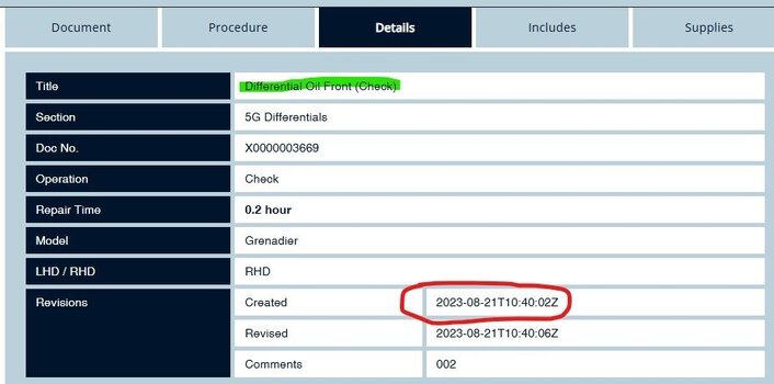

It seems clear to me that if 2.1 litres was put in during the drain and fill and there has been no leaks, the SST will confirm the oil level is still correct. It's slightly more accurate than a finger dip. Read along with me please:

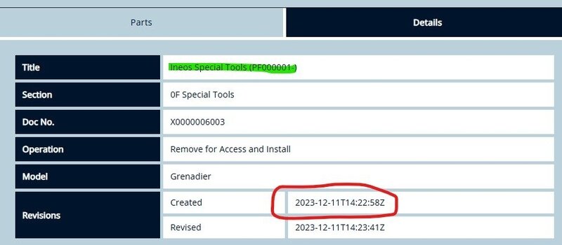

Finally; there are many instances where SSTs are coded in the workshop manual as SSTxxx. That doesn't invalidate the tool. I'm confident that just means that the SST PN wasn't available at the time the procedures were written and they haven't been updated since.
The front diff oil level check procedure is dated 2023-08-21.
The special tools list was compiled on 2023-12-11.
Attached.
The special tools list doesn't have images and the tools are not hyperlinked in the procedures. It could be any of these:
Item 630. GRA-0F00-017410. Gauge
Item 820. GRA-0F00-017600. Filler Device
Item 850. GRA-0F00-017630. Measuring Adapter
Item 1020. GRA-0F00-017800. Gauge
Item 1100. GRA-0F00-017880. Gauge
Item 1210. GRA-0F00-017990. Gauge
Attached.
