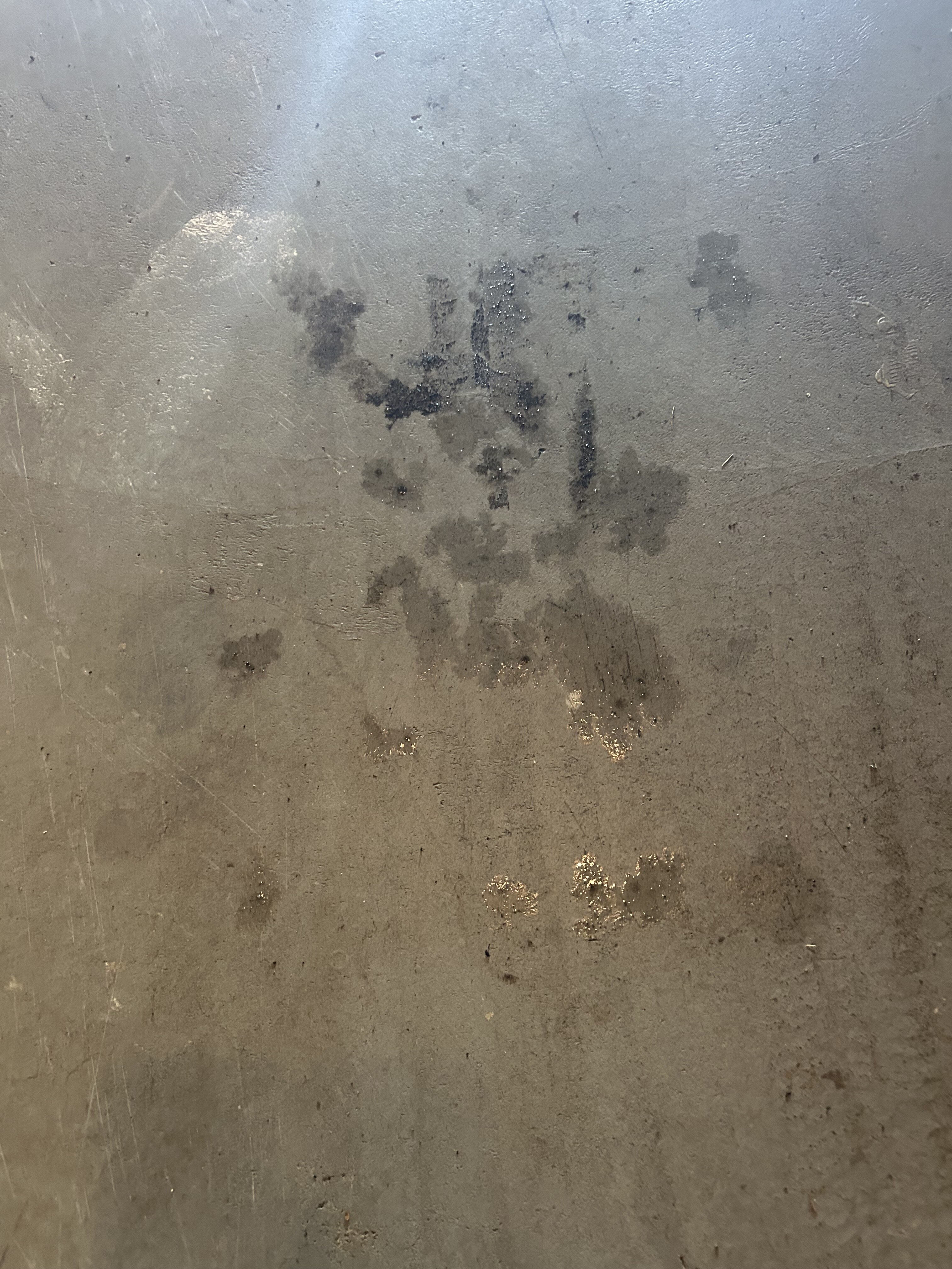

Thanks for reporting and welcome to the club. I am now starting my fourth week without my Grenadier because they are awaiting a replacement seal for me. I had 2000 miles and took delivery December 21st, 2023.
I have a little bit of oily film on the front output shaft, rear output shaft is dry as a bone... hope I don't have the start of the leak. 2500 miles on the odo after getting it 6 weeks ago.
Monitor the floor of where you park overnight. I had droplets like this
Will do, I cleaned it up to see if i get anymore residue as well. Hopefully the oil film on it was left over from assembly or something benign. Fingers crossed...
