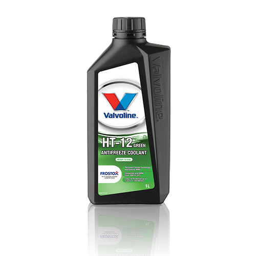

"Frostox HT-12 anti-freeze and corrosion inhibitor was originally introduced from 03/2018 exclusively in technical campaigns for selected BMW vehicles. As of 07/2018, some series are factory-filled with Frostox HT-12 from new.
This coolant can be mixed with distilled or deionised water. The mixture ratio is 1:1. This provides antifreeze protection down to -40°C."
My pleasure, I've learnt all about Frostox HT-12, a product I'd never heard about before and my life is all the richer for it. 😁
Perhaps I can add a little to your knowledge (but may be you already know). It's a VW product as well and produced by Valvoline:
In Germany there is a supplier which a comparably low price:
Yes, apparently there is even more I can know. 👍
But no tests of retained knowledge please.
