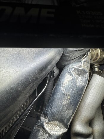

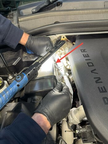

If nothing makes sense check the engine bay for wires that have been rubbed through and are shorting out and sending dodgy signals.
My technician found this after perhaps the 5th trip to the service centre.
Including being towed, and all manner of adblue sensor replacements.
It was only after an engine fault code was detected which said check wiring. Since then (touch wood) smooth sailing
