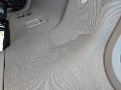

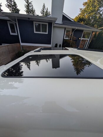

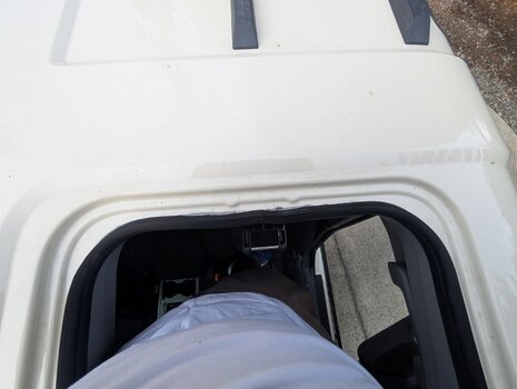

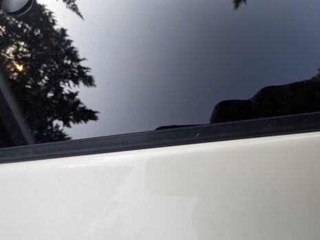

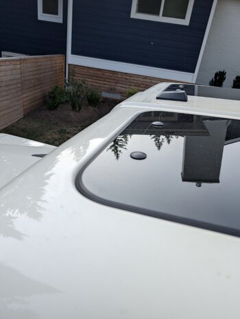

It's not a matter of time. Its just a few OZ of water sitting there. there's no stack pressure. Someone isn't doing their job and pissing on your leg.
Mine is proper tight and it still leaks
Tomorrow I'll post the solution my dealer did that seemed to fix the problem. PACNW gets it's share of rain. No issues post fix.
Mine will not leak unless parked on an uphill slope of approx 9⁰. Have you done that overnight in heavy rain without leaks?
My seals have been changed many times, are fixed in with black silicone. The glass shut has been made much tighter and it still seaps in between the glass and the seal at the back parts

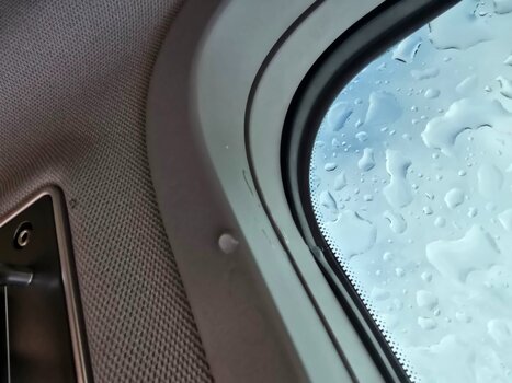

The seal on the frame looks pinched on the last photo. I would take out the rubber seal, clean up, reseal with black silicone etc and refit the seal or new one. Needs reseating again.
Dealer has done this numerous times, I will request it's done again.
They are contacting IA for advice

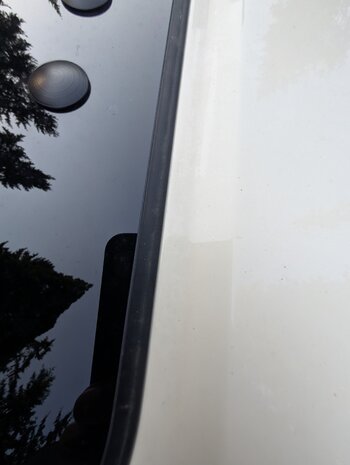

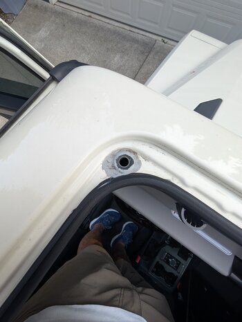

Here are pictures from today. Some on how it looks with them closed and then window out. You will notice they went wild with the sealant and even used the sealant on the rubber grommet that leads to drain hole. Since I was up there, I did clean around the seas with just water. I have a sunroof cleaner kit that I will use as fall wraps up. I also use canister of compress air to blow down the drain holes from time to time.

That sealant application looks like a blind person did it.. wtf!?
