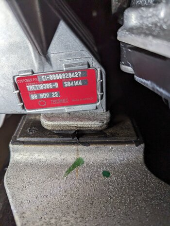

Check this screen shot. Would this signify that the transfer box has been changed on later iterations of the Grenadier
Weren’t early boxes something like “A” and then some were swapped for updated “B” versions?
No idea. I missed that one. Seems like different transfer boxes for petrol and diesel.
In 2023 there was a batch of transfer cases swapped out on low VIN vehicles under a service campaign that only applied to specific installed serial numbers. There was some discussion in this thread.
I never got to the bottom of why. I heard from an IA rep that it was due to an assembly shimming error and from another source that it was due to a gear manufacturing error with a misdrilled lubrication gallery. Either way, a batch of -A spec cases were swapped out for a -B spec case as marked on the data plate. The -B cases pre-date the service campaign so 🤷‍♂️.
This is my transfer case plate. Pic was taken on August 1st, 2023 after my transfer case was replaced two days after delivery.
