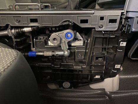

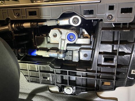

Center Differential Lock
The center differential lock function uses a 90° bell crank outboard of the shifter. One arm engages a ball on the shift column via a loosely fitted blue plastic bushing; the other arm transmits motion through a ball joint and cable to the center differential lock in the transfer case. The ball joint centerline sits 13 mm above the bell crank arm mounting surface.
As supplied, the rod end measures 36 mm from joint centerline to the end of the threaded barrel. I reduced this to 28 mm, leaving approximately 16 mm of hollow barrel. Because the barrel threads did not run the full depth, I used a bottoming tap to extend the M8 × 1.25 mm threads to full depth. I reduced the height of the cone-style insert so the total stack - rod end plus cone - measured 13 mm from the bottom of the cone to the bearing centerline. A 35 mm bolt secures the assembly to the bell crank arm. Ineos applied thread locker to the OEM ball stud, so I chased the bell crank threads with a tap before installing the new bolt with medium-strength thread locker.
Here's a picture of the differrential lock parts stack:
High/Low Shift
The High/Low shift function uses a ball link screwed into a threaded steel boss projecting from the outboard side of the shifter column, above the center differential lock bell crank. The joint centerline is 18 mm above the mounting plane. I used the same parts as the bell crank modification, but with different dimensions. The rod end was shortened by 2.5 mm to a centerline-to-barrel-end length of 33.5 mm. The cone was left as supplied and I added a thick-pattern washer beneath it to bring the stack to the required height of 18 mm. The spacer required is approximately 2.5 mm thick; I made it from a thick M6 washer drilled out to 8 mm and honed to the required thickness. Standard washers are typically about 1.5 mm thick, and the shifter geometry is such that stacking two of them would likely work equally well without adversely affecting cable alignment. The M8 × 1.25 mm × 40 mm button head bolt was shortened to 38 mm to maximize thread engagement in the threaded steel boss on the shifter column without bottoming out - approximately 16 mm of thread projects beyond the parts stack. As before, Ineos used a lot of thread locker on the OEM ball stud; I chased the threads with a tap, then installed the parts with medium-strength thread locker.
Here is a picture of the High/Low parts stack:
Here is a picture of the installed spherical rod bearings. Despite being larger than the OEM parts, there is plenty of clearance around the new rod bearings in all four positions.
