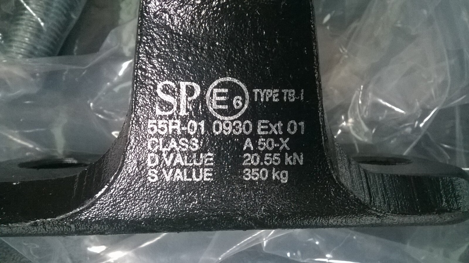

I'm happy to learn but I thought E11 just signified the approval country was UK, and in the same manner:
www.testups.com
The actual regulation is "55" and the long number is the the actual certificate number.
