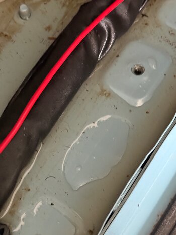

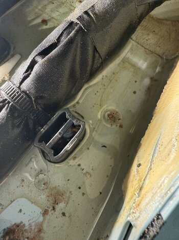

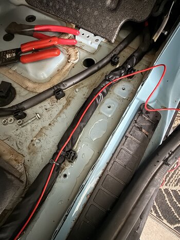

Yes, lots!! No safari roof though! That’s my problem right now.

That’s the plan for today, but it’s been leaking for months and a new windscreen was installed last week. No bad sealant was found and upon re instillation the leak persists. So it must be coming from elsewhere.
