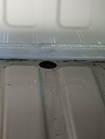

Thanks to the pics that ADVAW8S presented, it would appear that there are drain plugs in the forward section of the tub that are hidden under the plastic tub liner. I would just pop the plugs and then drill some holes into the liner.

I’m assuming those plugs are underneath the bed?

I pulled the plug and felt metal when I stuck my finger in the hole. I assume you would need to run a tube somewhere.
Interesting that you felt metal after pulling the plug. I’m wondering if there is a channel designed in there to help prevent road debris and little critters from migrating into the bed. Maybe if you poured some water into the hole it would still drain out?? I can’t imagine those plugs are for anything else but for drains, but I dunno🤔.

Update: I ended up drilling some holes near the tray bulkhead, inboard of the wheel arches. I took a WAG and went with a half-inch hole. It's working nicely. However, despite my best efforts, I think the placement isn't optimal. The hole seems to be above some sort of frame support. The water drains well enough, but you can hear it dripping on the frame support.
