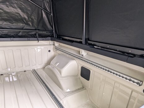

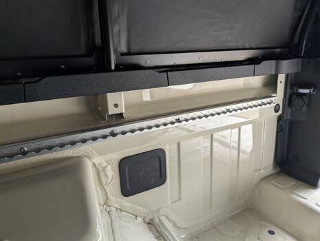

That was my truck and I had the install done by my Ineos dealer. They order everything and it fit perfect. You will notice the black plugs on the side and those are the attachment points for the L track.

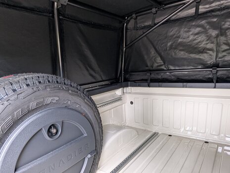

Yes the dealer ordered it. The spare is in the tub still. The removed the tire and then installed the L track and put the tire backed in. I put the canvas canopy and not the tonneau cover. You will notice the attachment for cover has installation points above the L track attachment. They are screw holes in pillars. So you can still have L track.
