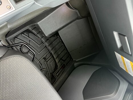

I've got a chronic leak in my right side/passenger footwell, the dealer has addressed it a couple times. They've absolutely reduced the volume using copious amounts of sealer but have not stopped it. This is not from crossing rivers this is just driving in the rain. The dealer has traced it to the firewall around the cabin air filter and air intake. Started at about a pint sloshing around after a drive in the rain now just a shot-glass or two. Just one of the many "known issues" that makes my Gren the award winner of my "fleet" for the most visits to the dealer by far. I love the idea, loved the classic defender and it even reminds me of one of my other favorites, an '80's bronco... I really want to love it but its execution is so poor that its a garage queen, grocery getter nothing more. Not dependable or robust enough to compete with my wrangler or ram for real hard use in my world of remote construction jobs in hard to access areas.

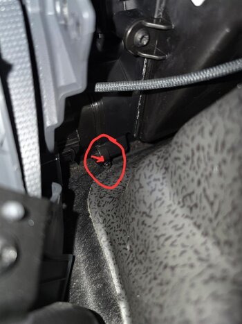

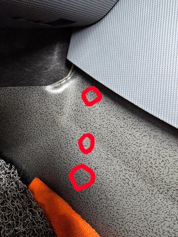

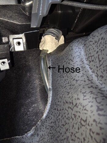

Mine had 5 of the leaks -
These three were addressed by the dealer -
1. Safari Windows
2. Rear cargo area / crossbar flooded due to incorrectly installed rear seals
3. Water leaking in the rear side panels due to incorrectly installed grab bars (or something like that, it was not clear)
4. The toot horn became waterlogged (this has been an issue twice now)
The unaddressed one is the passenger footwell. From the last visit, the dealer had someone from corporate come try to fix it and the end result was "This needs an engineering fix and redesign, we will let you know when that is done. For now, don't turn your A/C on '4' while it is raining. And try to use recirculate."
