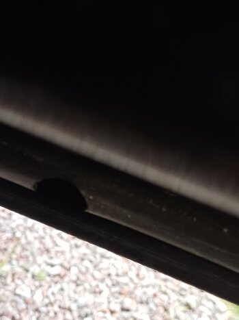

How old is the vehicle? Have you got the new door seals? The new ones have 3 semi- circle holes cut in the door seal at the bottom.
I can not find any holes in the door seals!🥸 Can You provide pictures?

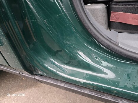

What I found is a waterline from the dammed water.
My thesis is, that the water will drains into the frame when it rises e.g. as high as the hinges of the doors are.
Regards
Regards
You should have 3 of these in the door seal. My was built 10/23 and had them factory fitted. You must be one of the last build with the old seals.
In my view, this does not eliminate the cause. At that time, I also had water in the door frame, which ran out like a waterfall after opening. My dealer said at the time that there was a recall campaign in which these semicircles were punched out of the seals. I told him to just keep his hands off it. I'll take care of it myself. I put the door seals in the right position myself with 3 M adhesive tape. Since then, I've never had any problems with water collecting.
