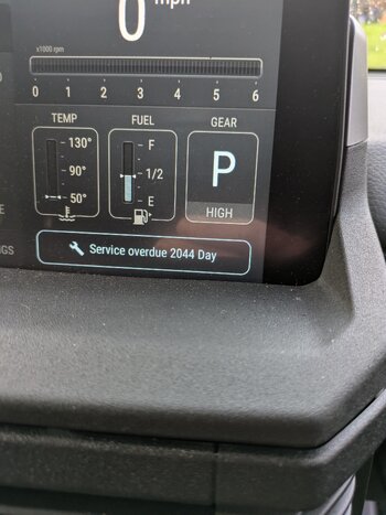

New Year Service Overdue Bug
1927 for me
A good friend yesterday rang me to tell me their Tesla had a special NY light and sounds function just delivered to their vehicle.
I rang them this morning to say that Ineos also has delivered a NY light and sound function, but it goes Bong and you can’t turn it off.
Yup, we are the same. 1906 for us.
G.
2044 here.

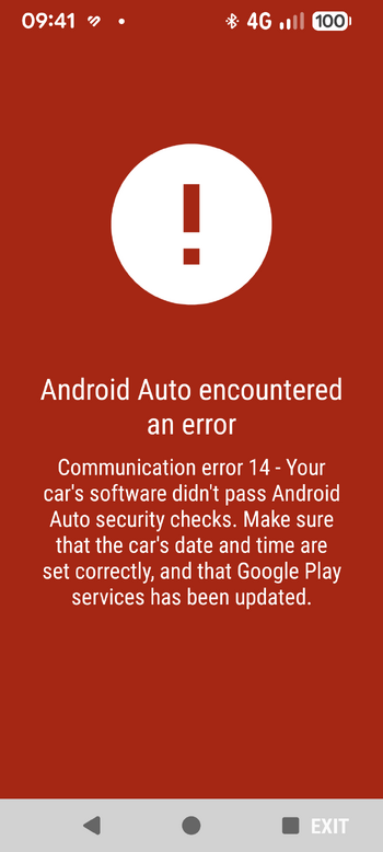

Also Android Auto error.
My date was showing 01 01 2016.
Manually changing the year sorted Android Auto, not the service reminder.
I have driven my Ineos 2 times today, and all normal, so it is not affecting everyone.

It appears that the bug resides in the customized vehicle integration layer, not in the Neusoft base software, and requires an INEOS firmware patch to update the VIN- and region-specific service interval calculations and reminder logic, to be deployed via dealer. Mechanically, however, the Grenadier may well be the best car I have ever owned, so I’m not particularly bothered by some merely annoying software glitch…
I would have thought the bug was caused by the Neusoft software incorrectly changing the date?
Agreed that the dealer tool is required to reset.
