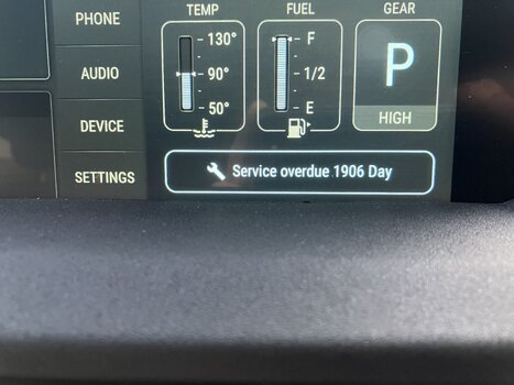

Yup, we are the same. 1906 for us.
G.

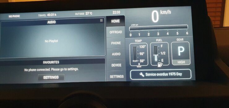

2044 here.
Also Android Auto error.
My date was showing 01 01 2016.
Manually changing the year sorted Android Auto, not the service reminder.

I have reset my current date back to 31/12/25, now waiting 30mins and will see what happens. If this works I will then reset the date back to 1/1/26 manually avoiding the automatic tick over of midnight. If the current test (to be checked after 30mins fails) I will set the date back a couple of days and let it midnight tick over to a new day in 2025 to see if the service interval bug clears and if so then perform a manual date reste to the current day in 2026. My major concern is that this must a bug in the library of functions used for the firmware as there is no need to have different code for calculating the service due date after a year tick over - my service due date has calculated correctly for the last couple of years. The firmware must have code that resets at midnight that has corrupted a system date which has then defaulted to a manufacture date.

Date and time correct on mine but in 3-1/2hrs I’ve now gained another overdue day on my service At 0859 hrs I had 2050hrs overdue. Now I have 2051. I think the race is on 💪🏼😂
