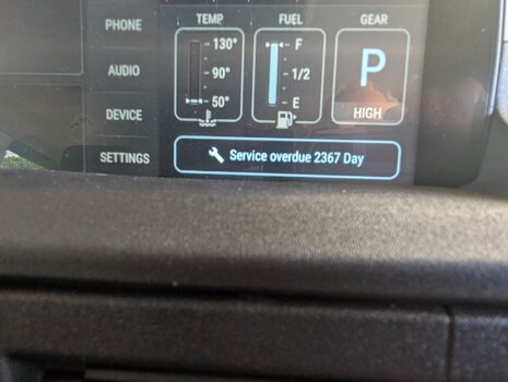

New Year Service Overdue Bug
Its exactly 6 years out from my service date (1995 days) (as if the date were 01.01.2032 but the cxar clearly shows 01.01.2026 in system time)

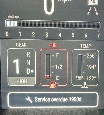

The first number to repeat, the same number of days as my car: 1968
Still only affecting cars with AU firmware.

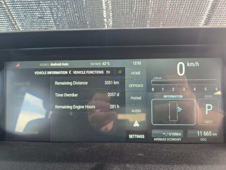

Also got the bug.
2057 days overdue.
Only had it since new from may 25 with 0023km on clock.
I know Ineos did long term testing on mechanical but obviously not on computer systems.
