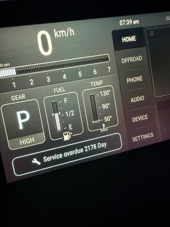

New Year Service Overdue Bug
Did anyone else experience something odd with their heater controls yesterday too?

Same problem here since yesterday morning…….
My nearest dealer has said that they will not reset my service interval, or at least they will but will charge £450.

Italy here:
Model 23
Service reset done on 21 Dec 25
on 1 Jan 25 Service overdue 1840 days
And yes coming back yesterday from the mountains the heater was really working for the first time - just too hot;-)
It looks like that they were trying to do some updates via LTE - in particular via the eCall system. However I think their SW release lifecycle is immature and I do not know why they were trying to update something via the air. Guessing the Grenadier SW is luckily not prepared for this. Anyway for me this is not a big issue. Still enjoying the car for 80k km.
And just to join the fun.... 2023 model. Next Service due in August.
Since this morning (didn't check yesterday)
2031 days Service overdue..... have to look where I place my flux capacitor and head back to 2020 for the service then.

Got a reply from my dealer.... they had contacted INEOS and received the following message back :
Dear Partners,​
First of all, let me wish you a happy new year.​
I hope you had some relaxing, quiet days with your families and friends during Christmas and had a chance to reenergise.​
We are aware that the new year has brought an error messages to many Grenadiers about an overdue service. Unless the car is actually late for its service, please ask your customers to ignore it.​
We are working on a fix to remove the error message and will keep you informed.​
Thanks very much.​
Kind regards,​
So I guess we just have to wait, but good that INEOS is already looking into it.
