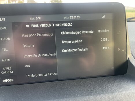

Notice how many values are hovering around the 2,048 mark (e.g., acky at 2,048, Commodore at 2,057).
  • The Pattern: In computing, $2^{11} = 2048$.
  • Hypothesis: This is a memory bit error. The "Service Counter" in these vehicles may be stored in an 11-bit or 12-bit integer. Once the clock struck 2026, the calculation for "Days since last service" exceeded the allocated memory space for that variable, causing the numbers to "wrap around" or pull random data from the next memory stack.
I couldn't find any 12-bit error patterns since it would easily handle all the reported error values.
With memory being so cheap over the last few years, you would think they'd be using a much more common structure like 16-bit or even 32-bit integers and COTS processors. (I know automotive stuff is hardened, but any more than a laptop or phone that can survive 3 foot drops on concrete?) But I can easily imagine automotive hardware / software providers cheaping out on both those items to eek out the last three cents in savings. The Infotainment screen can be interminably slow to display things like the Offroad menu. This is stuff that should be hard-coded, instantly retrievable from nonvolatile memory and not dependent on comm with a sensor yet. But it's painfully slow, indicating a less-capable processor or other bottle neck and - likely - weird stuff like 12-bit integers.

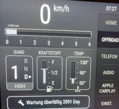

Joining the club at 2091 d

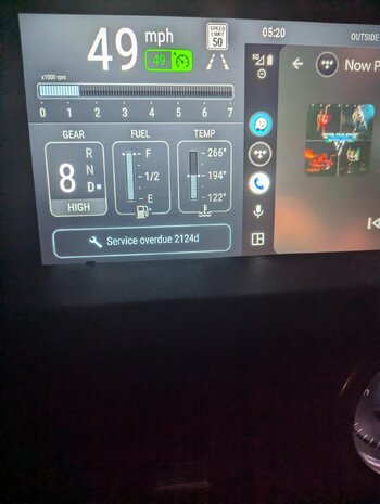

Got it on mine too.... little over 2124 days (5 years and 8 months) overdue....long before Ineos was building cars. LOL
I let Hendrick Ineos in Charleston know about it.... am sure will be an update.

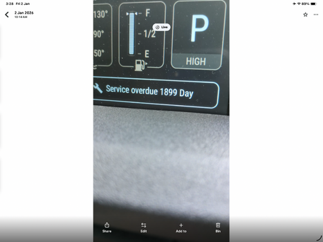

I went out for about 2 hours today and when I got in the car it said 1898 when I gout out 1899, it gets stranger.
If anyone has the BMW reset tool, I suspect all we have to do is reset the service due and then get an update before the end of the year so we don't see this again next year. I should have access to a tool this afternoon and will test it..
I’m guessing you are new here….
The image names (and their inferred sequence) suggest your days overdue notification became smaller. Is that what happened?
I'm not sure what time of day one day rolls into the next on Planet Grenadier but it isn't midnight. When mine was genuinely telling me I was a few days overdue I noticed it would increment between the time I drove to work in the morning and home in the evening, so I suspect the calendar on Planet Grenadier advanced one day during your drive.

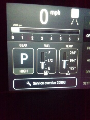

This showed up the morning of the 1st. The vehicle isn't even this old. Do I win?
2081 days overdue today so the damn thing is keeping track.
Edit: Okay I see others have even larger overdue numbers.
