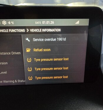

The actual answer is much simpler - the internal clock leapt ahead to 1 Jan 2032 rather than 1 Jan 2026 (2032 is the next occasion that 1 Jan is a Thursday). Number of days overdue was determined by previous due date to 1/1/2032. Even once the date is reset, the alert remains active until reset by dealer.
Spot on. My due date was/is 19.8.2026 and that is 1961 days to 1.1.2032.

I'm on 1980 days overdue, before the service reminder popped up my Android auto gave a security warning, checked the date and my Ineos my 23 had gone to the future... Aligns with an overflow error of some form....
That calculation would match in my case. Smart.
Mine was displaying today's date correctly (before and after connecting to my phone) and it's telling me it's overdue "1891 Day". The last service was completed on 31/10/2025 so presumably the next is due on 01/11/26.
The last service was a 3-day event which started on 29/10/25. The date 1891 days before 01/01/2032 is 28/10/26 which supports the 2032 theory.
This is an MY23 vehicle registered in October 2024 and is pre-ADAS. I haven't driven anywhere yet so don't know if the heater controls have gone (more than usually) haywire.
