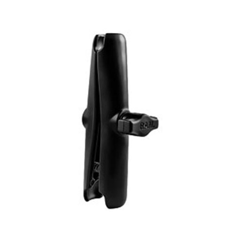

The materials you need: Two fittings, a RAM 9/16" ball joint arm and a 9/16" ball base.
The 9/16" is called the 'A' size ball, as opposed to the 'B' size which has a diameter of 1" and the 'C' size which is even larger.
Whats missing here are the two M6 nyloc nuts and their washers. The GoPro Adapter for the Gopro is on the next image.
If you look for such RAM accessories you will somtimes wonder about the prices. The 9/16" arm below is e.g. offered for 68€ in some shops 🥳, but you can get it way cheaper, I paid 18€ here and bought the 9/16" base there as well:

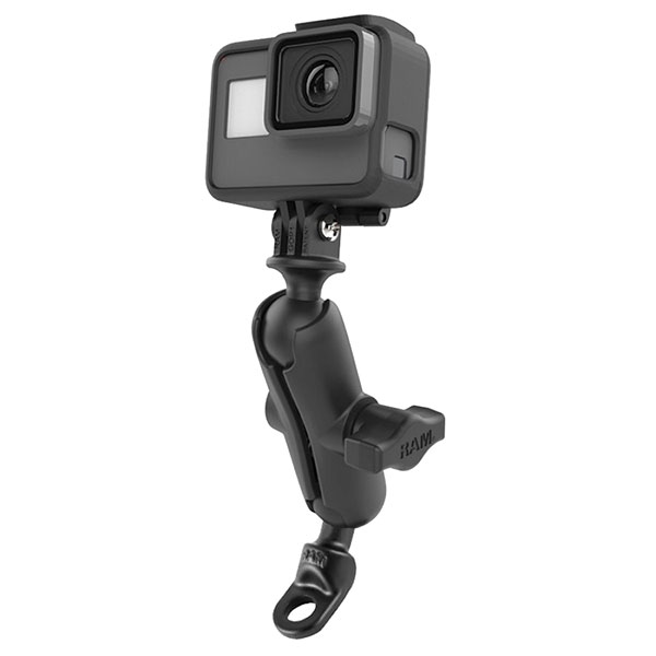

That's the RAM 9/16" arm with the GoPro adapter. If have taken it from a chinese assembly which is too flimsy for a serious GoPro mount, but the part from the assembly which I'm using here doesn't have any joints and is thus quite sturdy in this application.
A first view on the mount without camera. You can tilt the arm in any direction.
Here, the RAM arm is tilted forward. The back mirror always protrudes the camera mount, whether its sideways pointing or forward. So no relevant change of the vehicle profile.
You can point it downwards as well if you want to record the wheel actions. But I haven't yet tried this perspective.
In the position below you can operate the camera even while driving.

I have already tested it and made some footage. The mount is quite sturdy and there are no visible vibrations - not even on the damaged roads in Germany.
The camera can be taken off in a second as the RAM arm can easily be taken off by just loosening the tommy screw. I own an external power bank (Ulanzi BG-2) with 6800 mAh. It could be attached outside with an extra DIY-holder because these fittings allow you to basically attach whatever you need.

But you'd need an A-ball size for the RAM clamp. I haven't found RAM-arms with one side with an A-size and the other with a B-size.
Both sides of this ram mount are B size and marine garde aluminium alloy not plastic
Yes, aluminum, that's the standard, even for the chinese thing above. All parts I use are all aluminum and stainless steel. Plastic is junk as such a rig poses higher forces on the joints than one might think.
The both sided B-ball is indeed a solution. Since I want to mount two cameras occaisonally, it would however be a bit costly.
